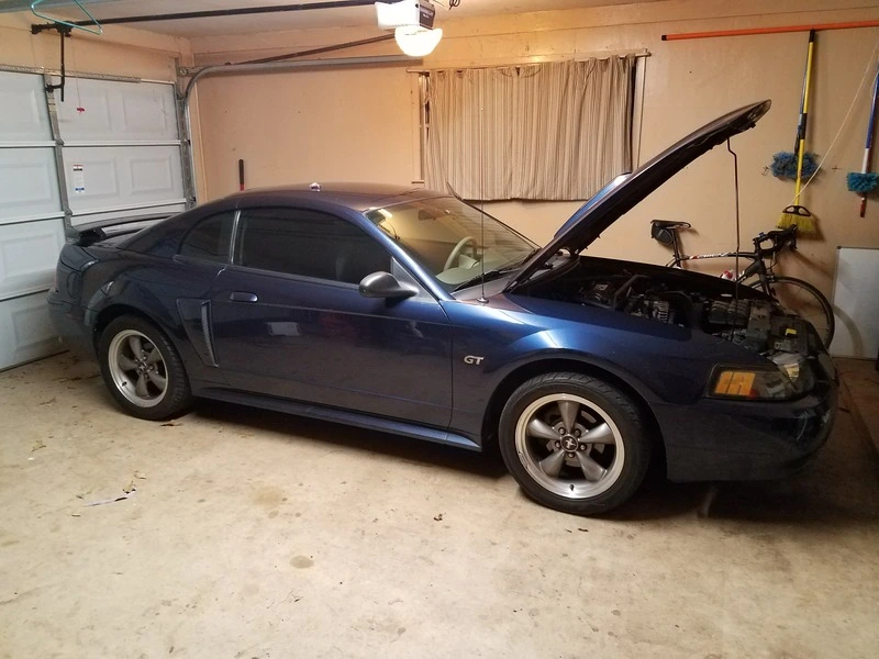

In December, I picked up an '03 GT, five speed, basically what I had in my '00 GT but the color I preferred. I then had surgery for a broken clavicle and had to watch it sit from January until April without being able to work on it. It was a major bummer.
Anyhow, I finally got healed up well enough to work again, so here goes!

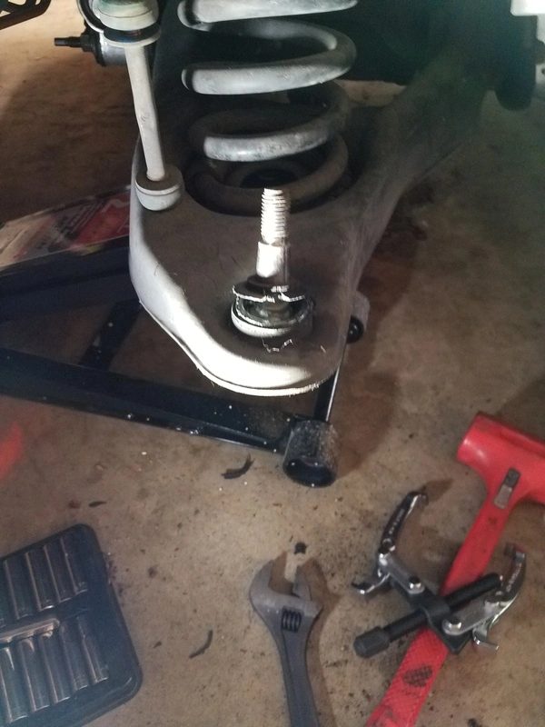

I'm going to be lazy here and just quote myself from my original post on this site, "In the last month, I've replaced brakes, shocks/struts, inner/outer tie rods, sway bar links, the rear spoiler he tried to repaint himself, installed FRPP B springs, front control arms, the intake manifold (typical coolant leak from cracked plastic), a couple of gaskets to knock off some other small leaks, swapped trans/diff/coolant fluids, installed an MGW shifter, new tires, and probably a few other things that escape me at the moment."

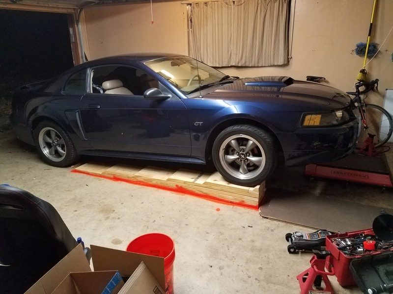

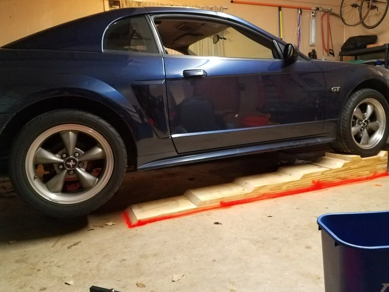

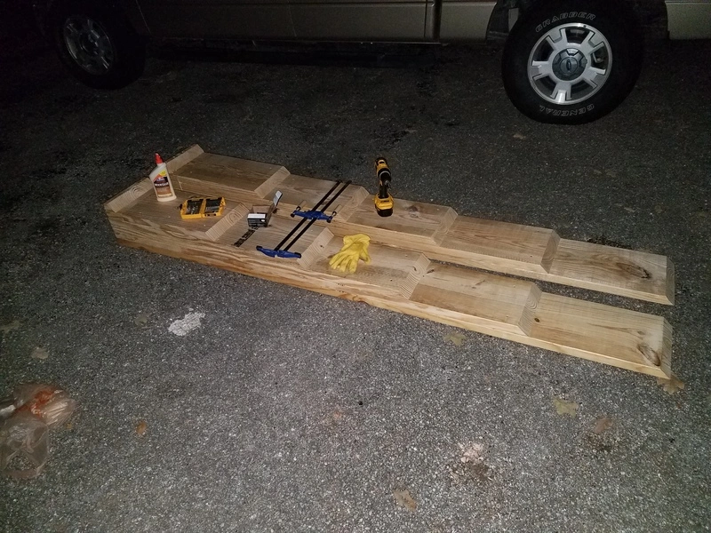

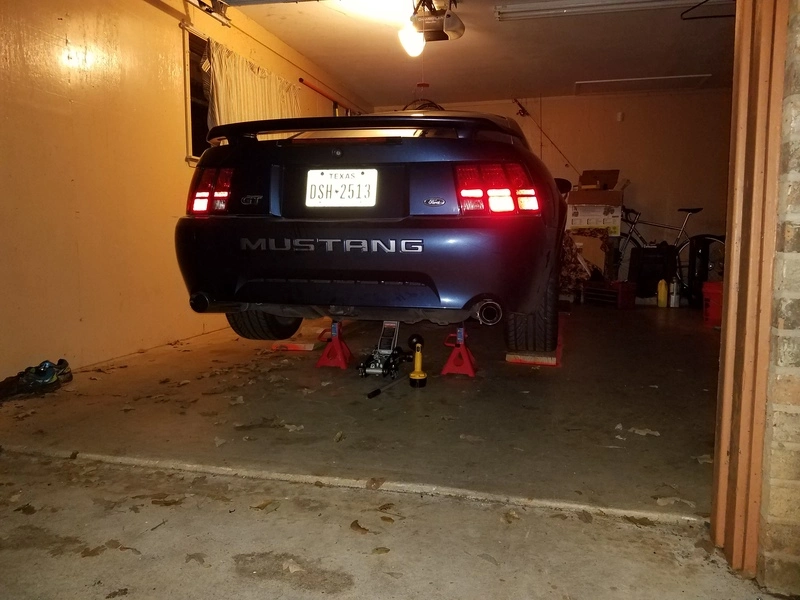

I don't yet have a lift in my garage, though I am considering it. Sure would be a life saver. I wanted some extra space though, so got creative. It's effective, but I'll warn you, very heavy. I will probably be cutting them off behind last step up, screw a nylon strap to it, and just lift the front of the car onto them with a jack. It would save me a lot of space in my garage, allow me to roll under from the side instead of just the front or rear, and save me money from not having to have hernia surgery.

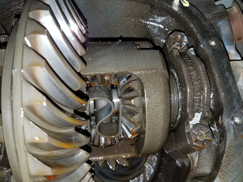

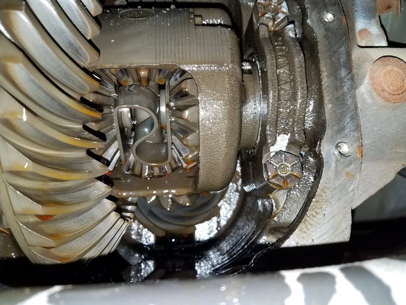

Opened up the butt end to see what I could see. Looked good so wiped out the stuff that sprinkled in, topped it back off with Royal Purple, and sealed it back up with a gasket. I know many prefer to use RTV, but I'll never understand it. I hate scraping the old gunk off and waiting for it to cure.

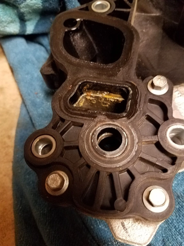

The kid I bought it from told me everything was all leak free but I found two, one minor and one relatively major. The minor one was from the seal between the oil filter adapter and engine block. I don't have pictures of that because by the time I thought to take one, I was already elbow deep in the project and didn't want to get my phone oily. I should ask my wife if she has a point and shoot I could borrow. That would probably fix a lot of that problem.

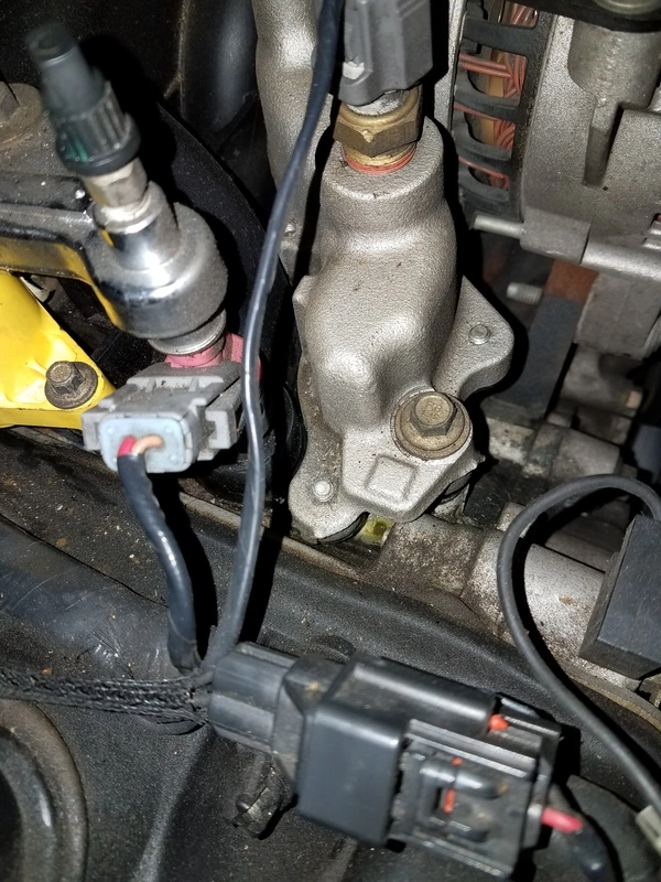

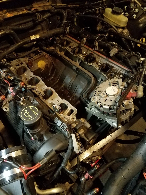

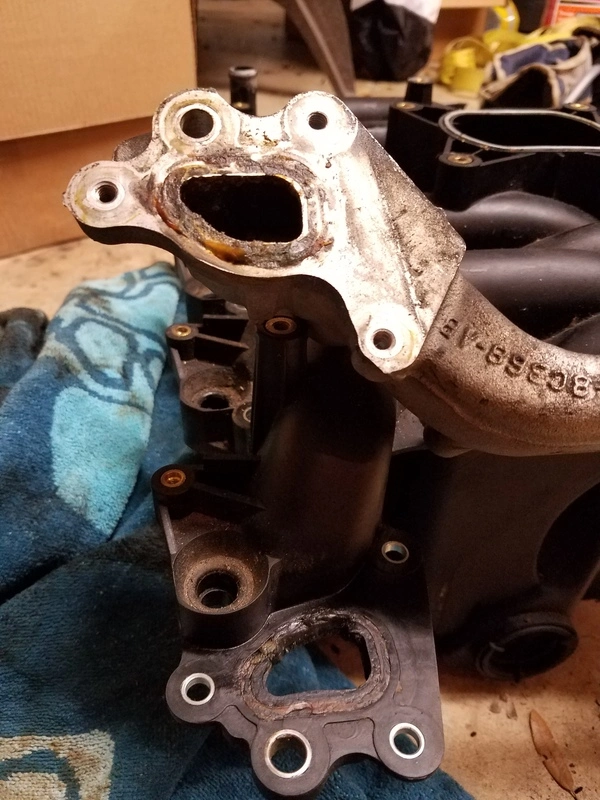

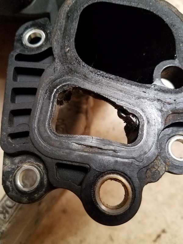

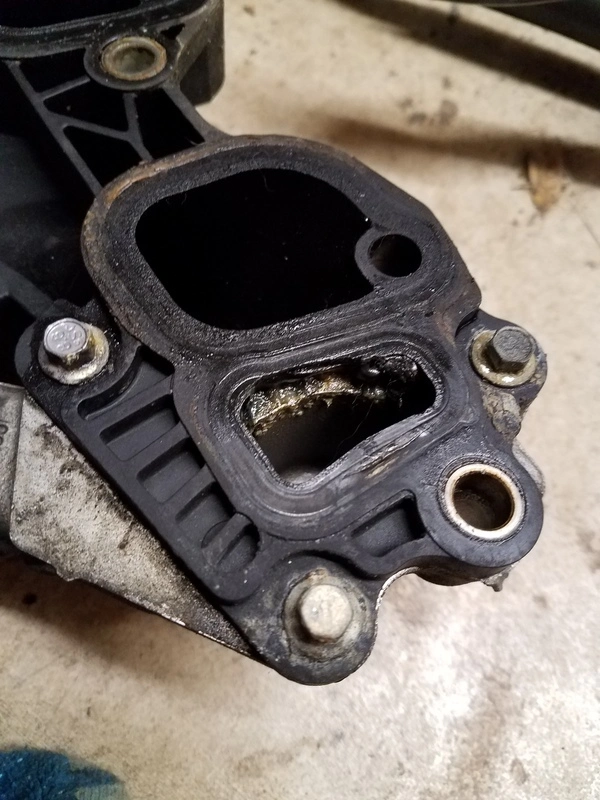

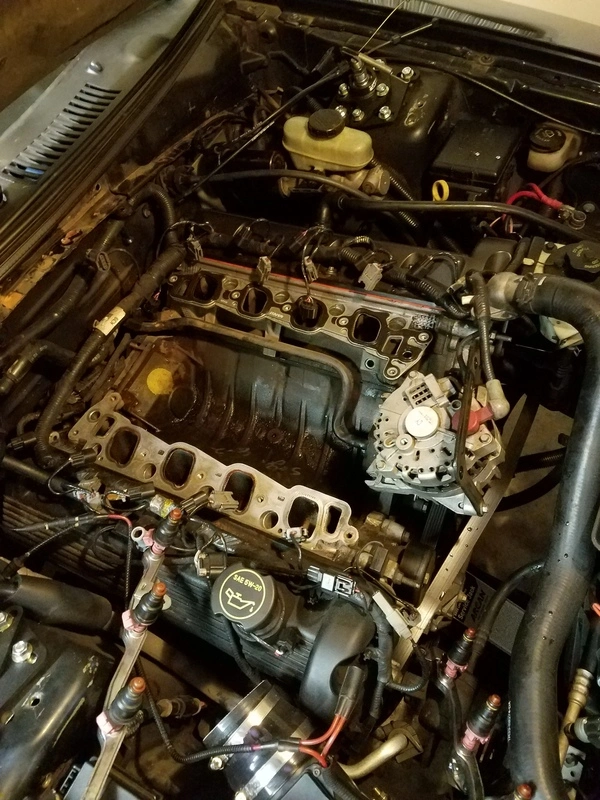

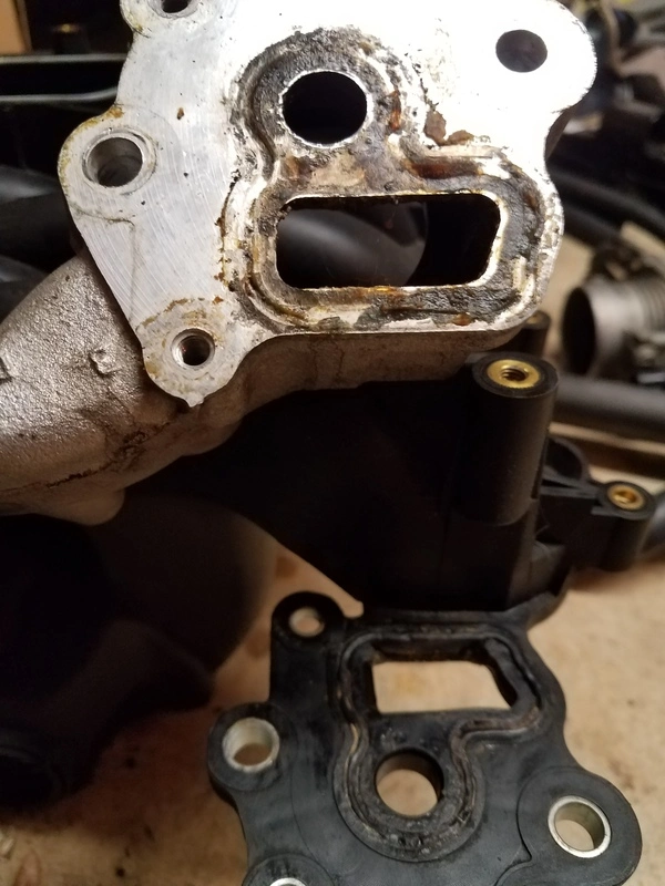

Back on track! The too major to ignore leak was coolant from the normal spot, the passenger side front end of the intake where the plastic cracks under the metal crossover. I bought the FRPP piece to replace it with (thought I can't tell a difference between the two, the dealer claims it's "improved") but regret that for reasons we will discuss shortly.
Did a little scrubbing in the valley with some degreaser so it didn't look like butt anymore. While typing the previous sentence, I also noticed something that bugged me; the PO put two screws through the top of the fuse block there to mount the fuse for his crappy amp. Most people shouldn't be allowed to play with electricity. You'll also notice the MM caster/camber plates, so I suppose I actually did this after finishing up suspension work. Ah well, we'll just pretend like I did it the other way around. I'm in too deep to change it up now!

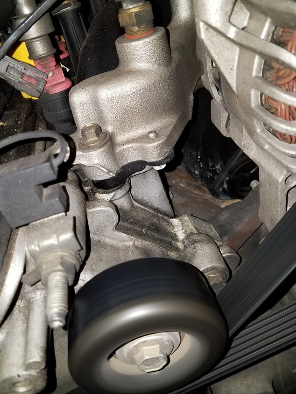

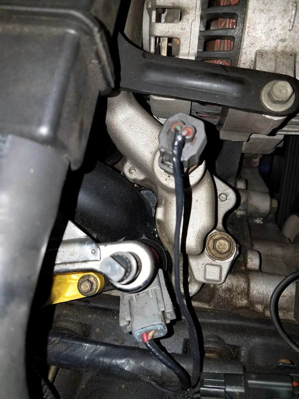

So once I got all this mess back together, I cranked it up only to hear that scary gravel-in-a-tin-can noise over my SLP LM, which was a bit worrying. By the time I got back to the front of the car, a pile of belt dust had already begun. A second later, my car threw it's belt at my face angrily. Luckily, I always wear PPE so safety glasses were in play.

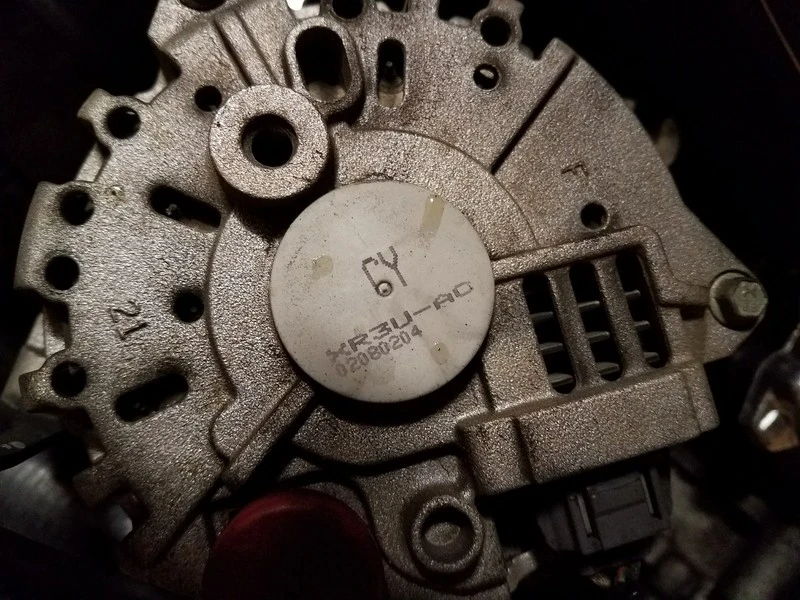

I played around with everything that's spinnable by hand. I couldn't pinpoint anything exactly, except I thought I felt a kind of tick.tick.tick when I spun the alternator as quickly as I could. I googled the PN on the back and was surprised/not really surprised to see that it was some oddball, cheap BS for $85 or so. It's a bit suspect when you can't buy an alternator for this car for less than $140. I bought a quality unit, replaced it, and the bad noises stopped. Some peoples' kids...
Link to alternator no one should ever buy: http://www.ebay.com/itm/NEW-ALTERNA...-281-V8-XR3U-10300-AA-GLV8424RM-/110787966170

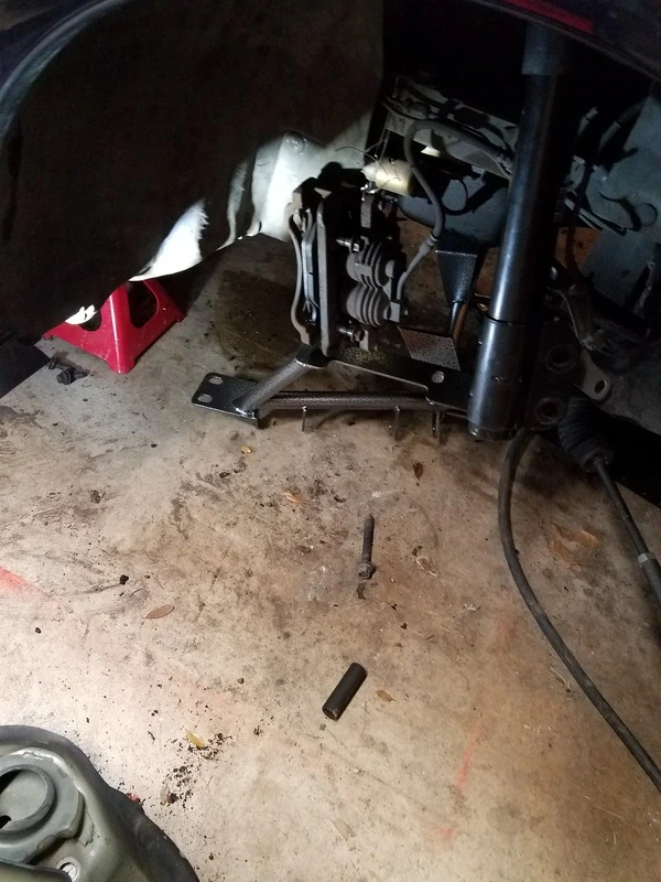

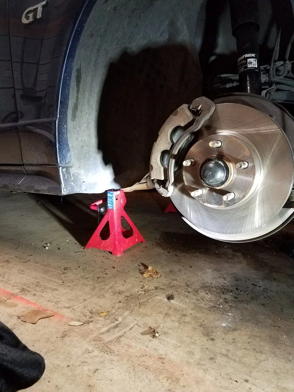

You can see the new brakes, controls arms, and struts from here. There are new springs all round, as well as all the other junk I have previously mentioned.
Looking back on it, I kind of regret not pulling the calipers and caliper hanger to be cleaned up and powder coated. Really, I could probably still do it because they're not on the hanger anymore.....

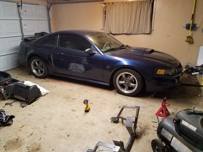

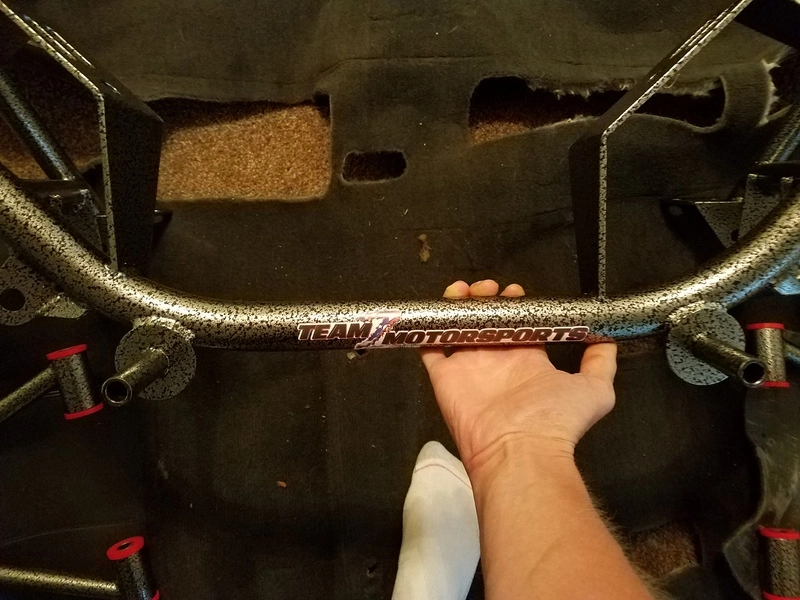

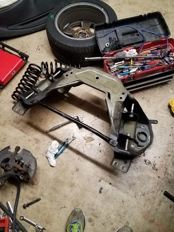

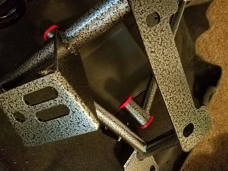

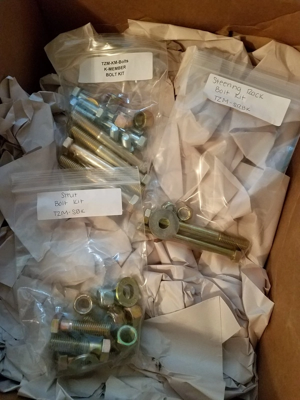

When I got it in from the UPS man, I excitedly opened it up expecting damage because the box was all donked up but it wasn't. What I can tell you is that I am very impressed with the quality and finish of Team Z's piece, especially the finish. I love it! There's so much room for activities without the factory piece in! The hand written labels were a nice touch too haha :D

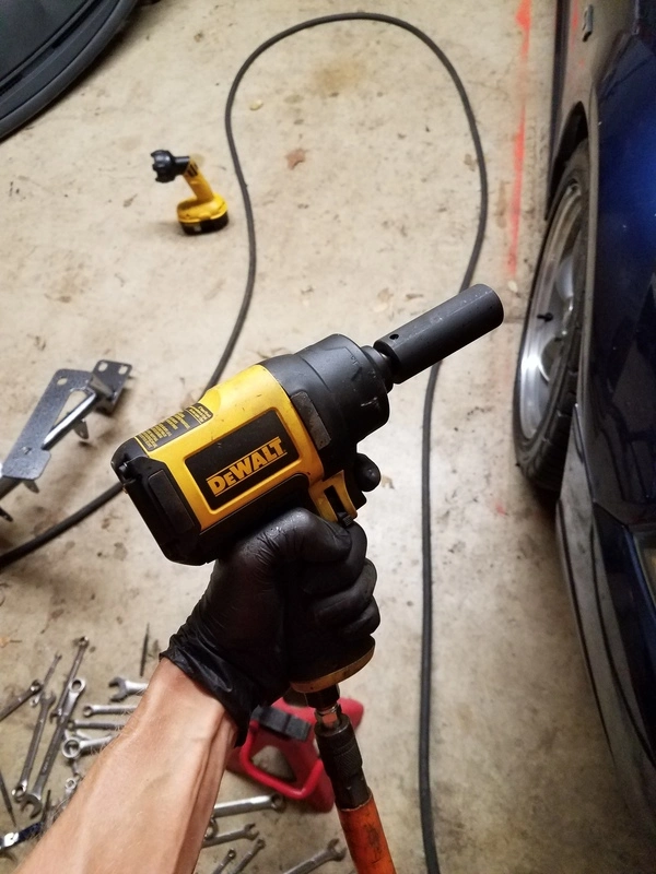

Remember, air tools are your friend!

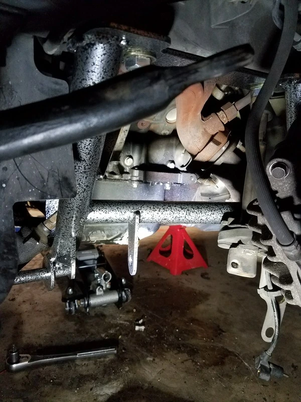

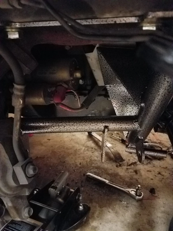

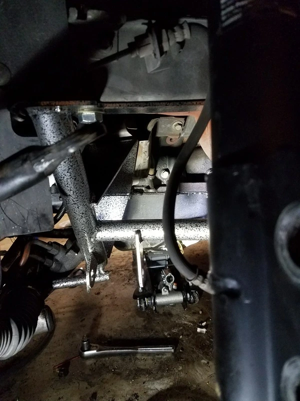

I was super excited so stayed up until 0330 in the morning uninstalling all my brand new parts and installing the k member. I didn't finish the whole procedure but didn't want to stop until bolts were in. I then got up at 0630 to go on a ride with my cycling club and now here we are. I need to eat lunch, then figure I can finish squaring everything up and put together the coil overs. I liked MM's idea of setting the wheelbase first, clamping a piece of angle iron in front of the k member on both sides to maintain that dimension, then using diagonal measurements to center it up with the rear end so I need to run down the road to pick up a chunk of angle iron to hack up.

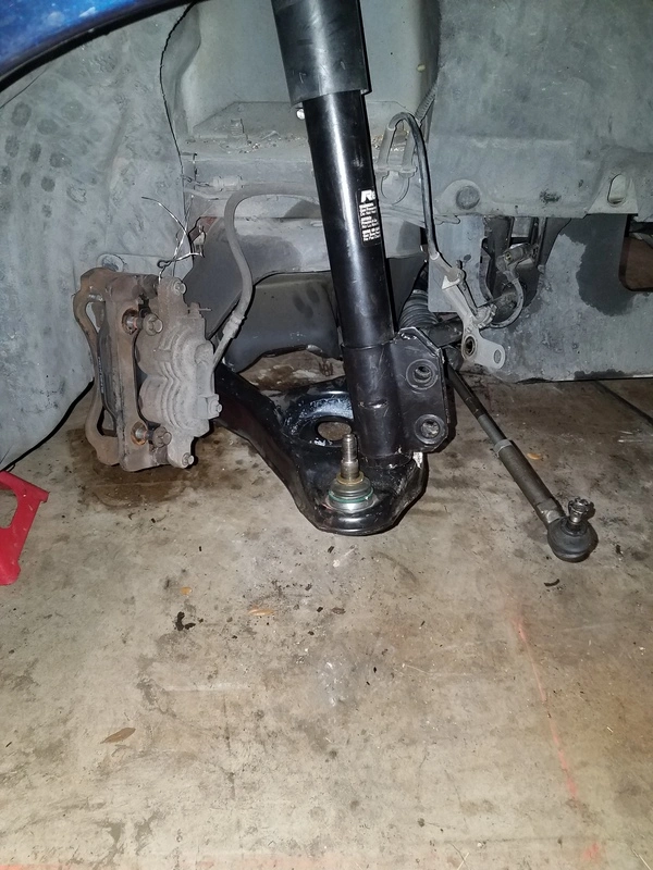

I've discovered that the struts I have won't work because like the Bilstein's, the bracket on the strut that bolts to the knuckle is too wide for the coilover collars. I need to purchase those, probably Koni, KYB, or Tokiko; I haven't decided which yet.
I cut out the factory rubber steering rack bushings because they were about shot anyways. With a 1.5-2" drop, has anyone had any experience with offset vs standard bushings? I will likely replace my tie rod ends with a bumpsteer kit so don't know if offset bushings are really needed. MM says they don't recommend them on a stock k because it can cam side to side. I have never heard of anyone having that problem but if a standard bushing works, it would keep the rack aligned simply because the hole is centered.
