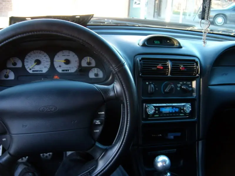

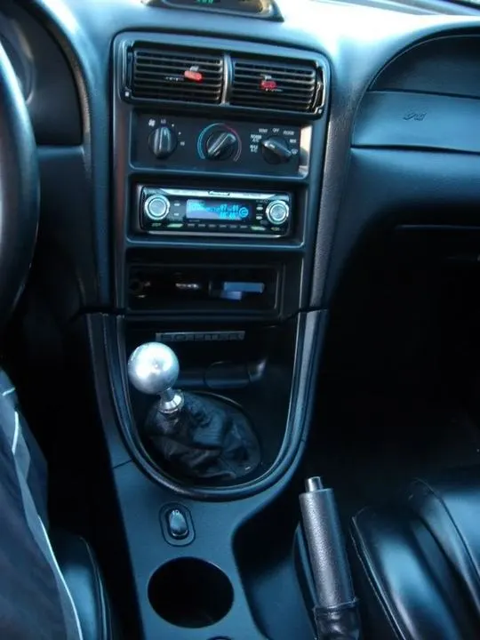

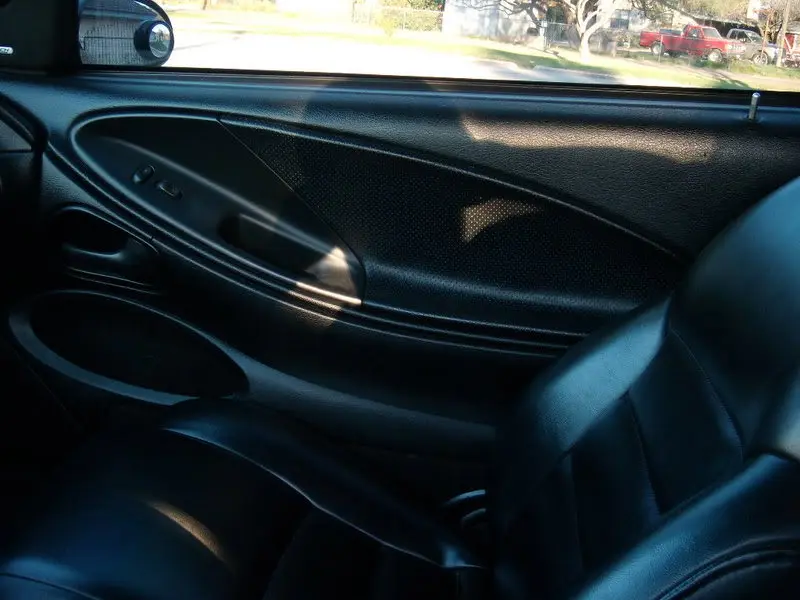

i had the black/tan (hate the tan!!) and used Duplicolor Interior & Vinyl spray that i got from Advance--i'd say it's pretty damned close (as close to 100% as you can get). see for yourself:
as you guessed, the top of the dash and door panel is factory black, the bottom *was tan until i hit it w/ a few coats of the afore-mentioned paint.
make sure you prep well (i cleaned the pieces w/ 3M dirt, wax, grease remover that was near the Duplicolor paint) and spray mutliple, thin coats.
