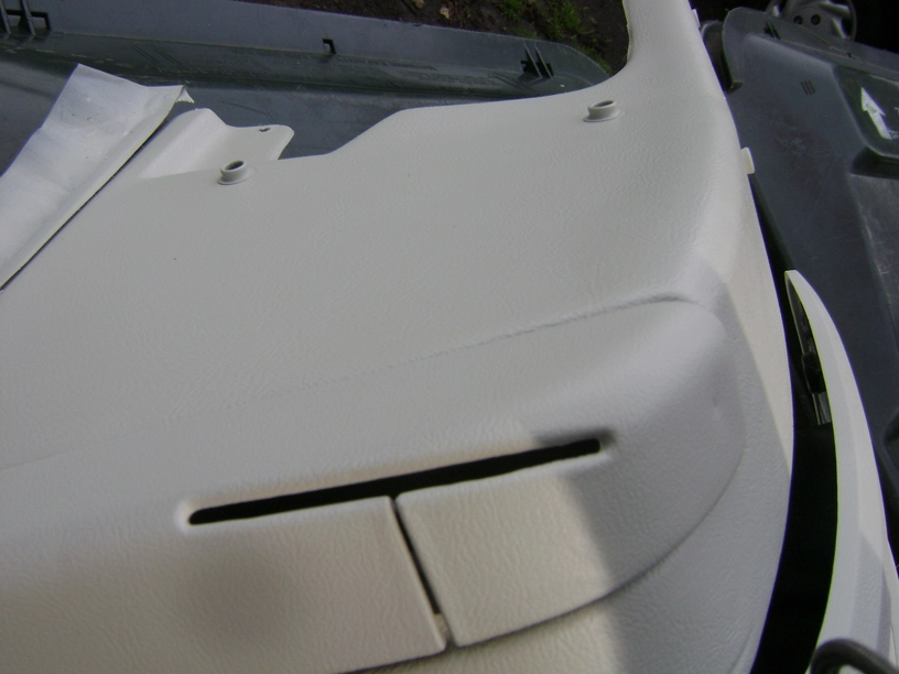

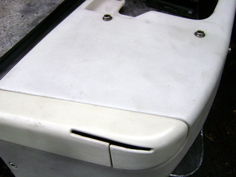

I used the white on my convertible's interior panels and not only did it match perfectly but it looks OEM.
Before (the camera flash drowned out some stains)
After
