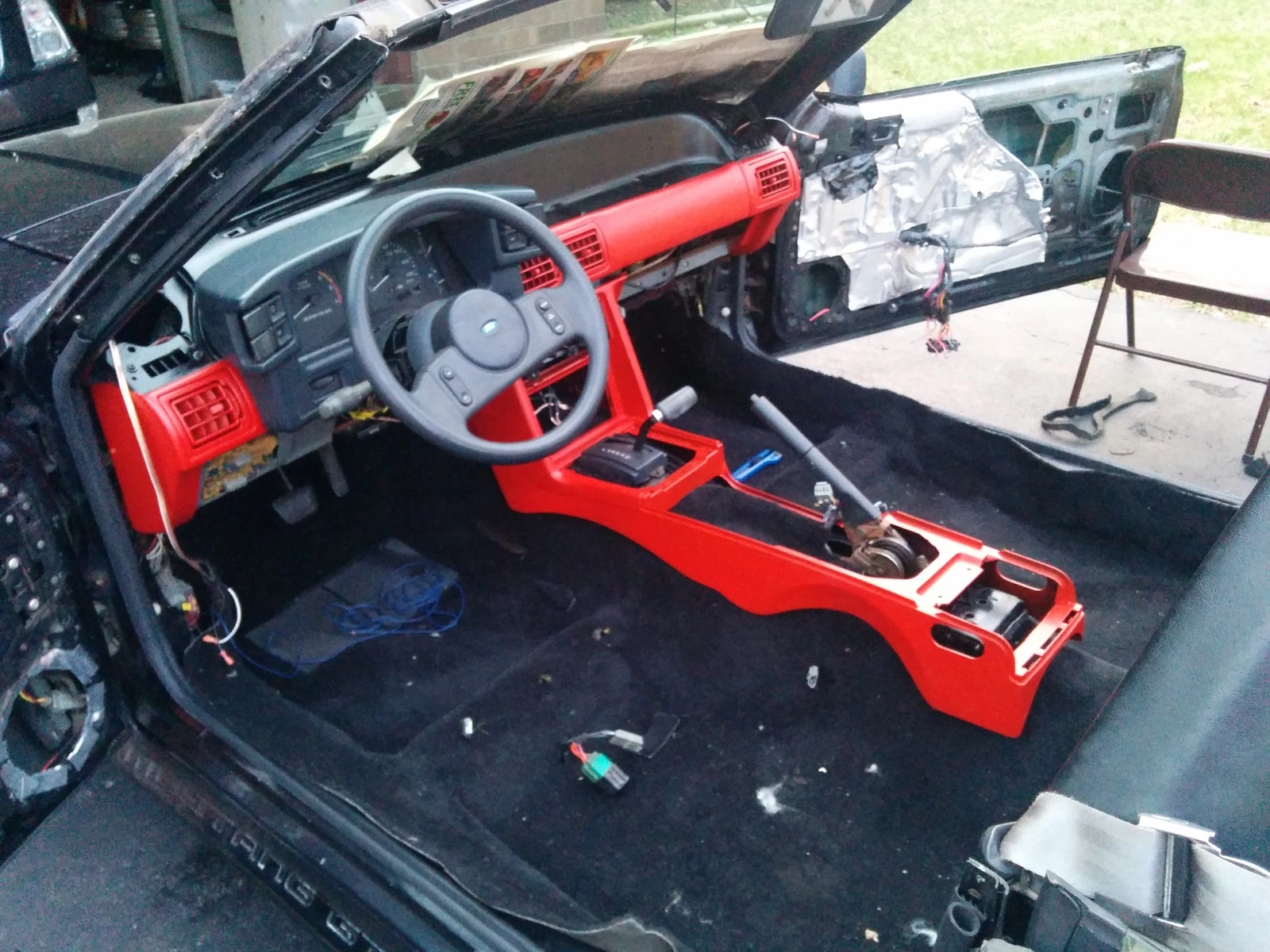

Mine was done with duplicolor interior paint. Washed with dish soap, Prep spray (and wipe it off) a few times, a couple coats of adhesion promoter, and 2 or 3 coats of the paint.
Depending on the color/year of your dash, the prep spray WILL start discoloring your dash. Ford painted some of the dashes. I'm really happy about it, looks amazing and durability seems above par. It will scratch off in some places but most of the time my fingernail can't peel it off or scratch it.
I don't like all red interiors and I don't like the dark and washed out red that came stock in mustangs. I like bright red with black highlights. This duplicolor paint is amazing, exactly what I wanted.
