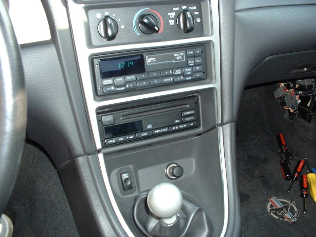

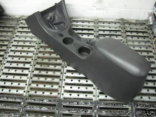

My console is in perfect condition, however I think it would look MUCH better if I replaced the console with one from a newer car and moved the TC and foglamp buttons after purchasing the buttons from a dealer. I plan on also buying a dead switch instead of the defrost button and mounting my line lock button onto it. The pictures are BAD...I understand that, but they're the best I have. The first picture is of a newer console and the second picture is showing my OLD stereo surround that I have replaced. I'll get better pictures and post them on here ASAP.
Does anyone know if that will work?

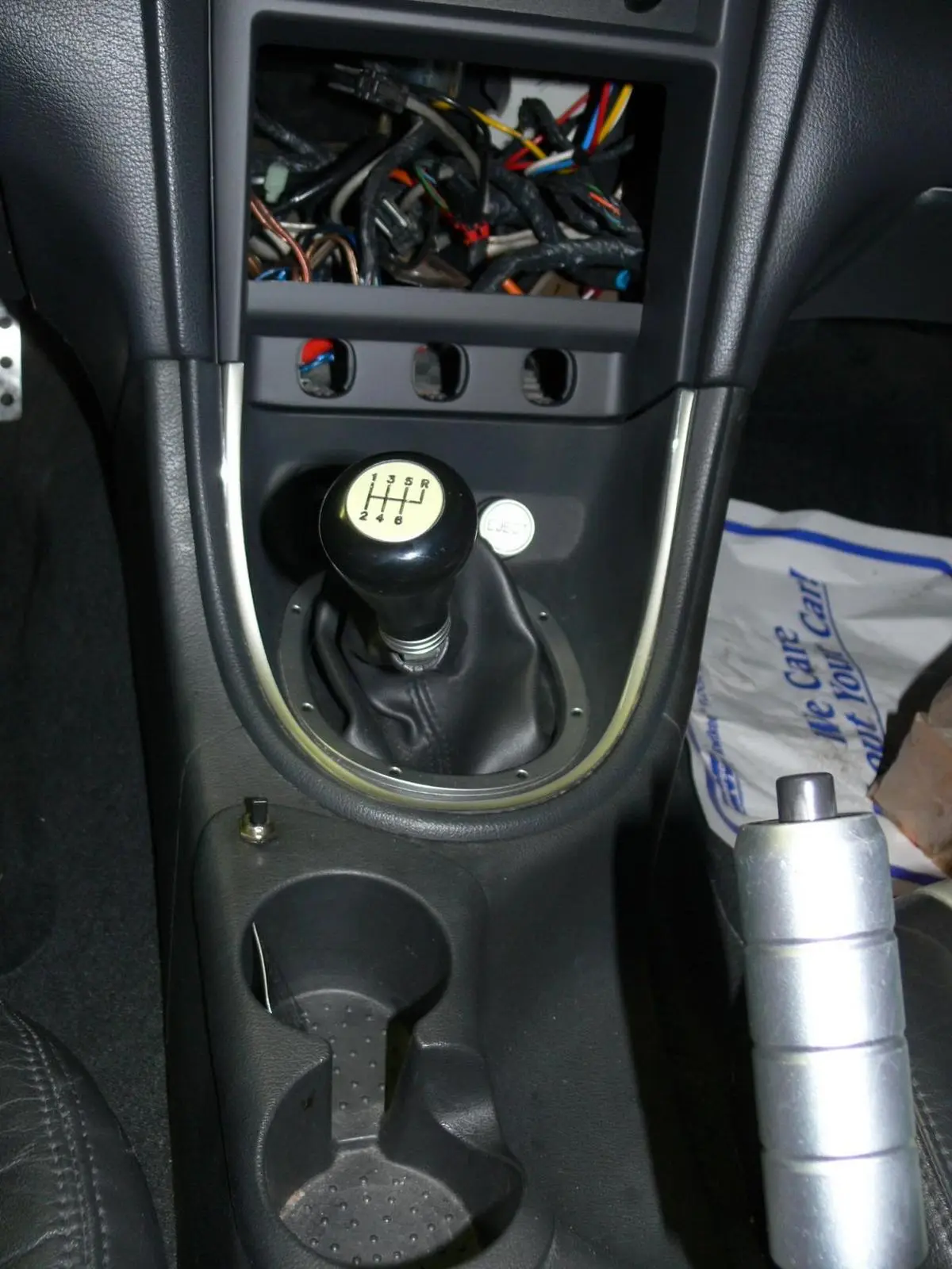

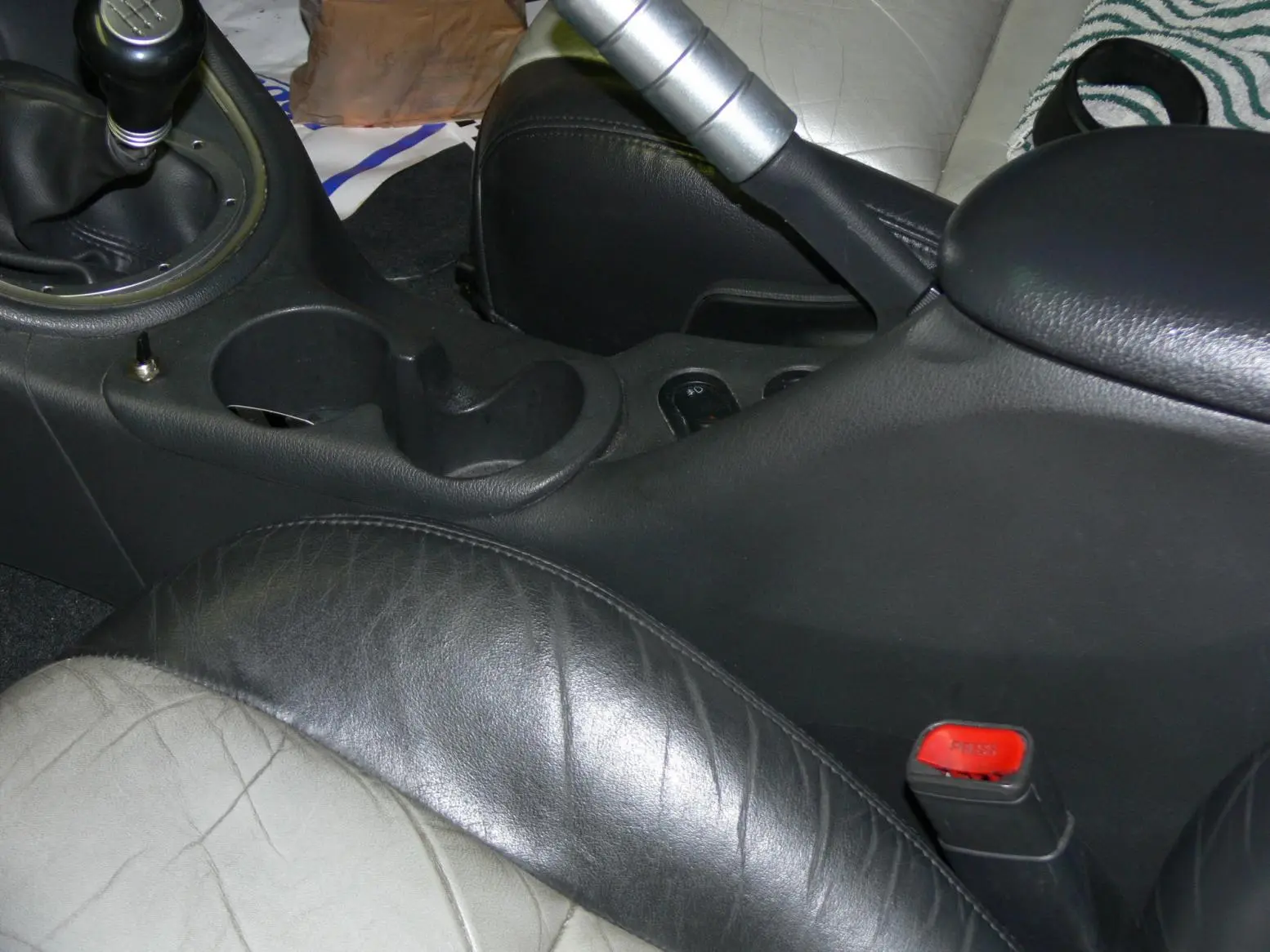

Here are some better pics. In the second one you can see the new stereo surround. It fits perfectly. The first shows just part of my current console...in comparing the picture above with the new console it SHOULD fit perfectly, right??

It wasn't as easy as it looks...I switched to an '01-'04 center stack, console and armrest. My '99 had to come out and the wiring harness had to be switched over. After peeling and re-attaching the wires everything went in fine. I had the interior pieces painted silver to match the silver in the doors, and in my opinion it looks great. There weren't any issues with the charcoal colors matching up.
