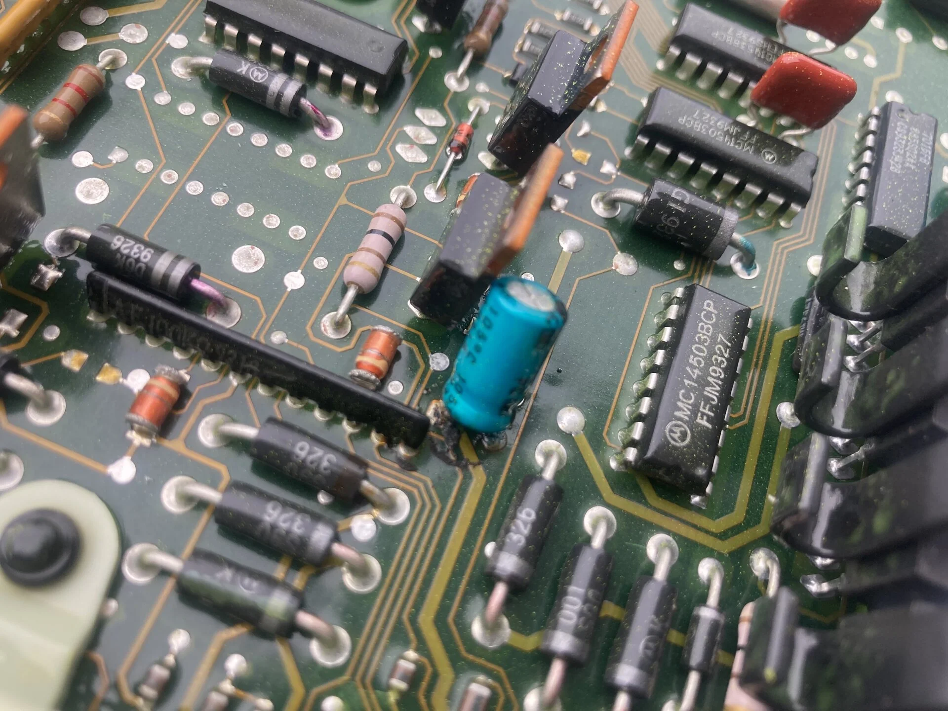

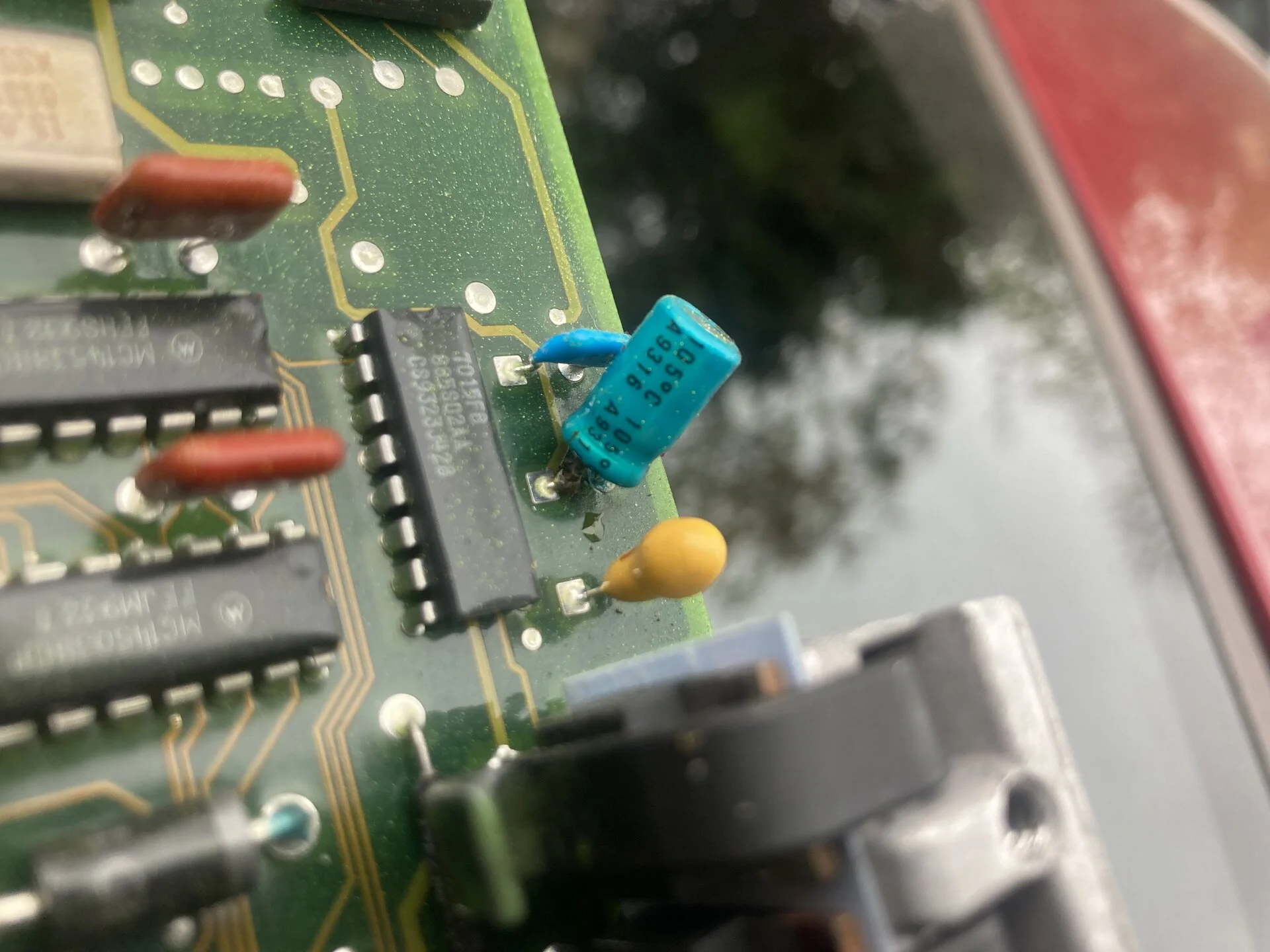

I took the computer out and opened it up. I did find what looked like a leaking capacitor with one wire broken. I took some pics and zoomed in, I think that what I saw, my eyesight isn't what it used to be.
So this would leave me to believe that its the computer. I found a place the fixes them for $120 and if they check everything and nothing is wrong, its half price. Sounds like a deal to me. However, I am a bit worried about the new relay that is acting differently that the original. If they were both good, I'd expect them to behave the same way. If the new one went bad, why.
It seems that I need the computer fixed anyway, but I am concerned that there is another problem.

Get the computer worked on, in the mean time make sure you have the grounds installed and the connections you dealt with are good, when the computer comes back use the old relay first, let us know what it does or does not do.
They received it Friday and got a message about it today.
The power supply in your computer was defective causing distortion on the system voltages. we also replaced the power supply along with the capacitors and voltage regulators. which are common to fail and this will prevent future defects.
