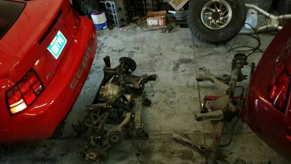

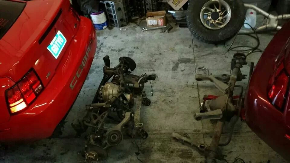

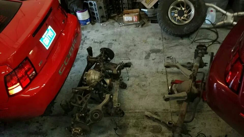

Cobra IRS is the only bolt in IRS option. Find someone with a Cobra that will trade with you. I swapped a guy with an 03 Cobra this summer for my 03 GT SRA/suspension. Cost me $500(my half of the labor). I had a new set of 3.73's and an install kit I threw in since I decided 3.55's where I wanted to be with gearing. VRI (Voodoo Racing Innovations) took this pick mid swap.

Cobra IRS is the only bolt in IRS option. Find someone with a Cobra that will trade with you. I swapped a guy with an 03 Cobra this summer for my 03 GT SRA/suspension. Cost me $500(my half of the labor). a new set of 3.73's and an install kit I threw in since I decided 3.55's where I wanted to be with gearing. VRI (Voodoo Racing Innovations) took this pick mid swap.
Ah ok. Im really surprised you got it that cheap. Actually im jealous. When im done paying off the terminator swap for my car ill probably put in irs...also what can i do to it to make it withstand 5-600 whp? i plan on drifting and sometimes drag strip...but irs is a little way off gotta save for flight school soon tryna become military pilot after college lol

Just what the world needs, another damn fighter pilot. [emoji12] But I digress.... If you get the IRS from an 03 or 04, I don't think they need much for that level. Already has 31 spline diff and half shaft. Only real complaint I see is the diff case cracking. The 99/01 had weaker half shafts and were more prone to breakage, IIRC. Replace all the rubber bushings with good bushings would be a biggie with either. Now, let's see how I did. @LaserSVT your opinion kind sir.
