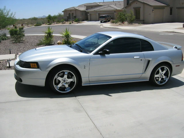

The pro-kit lowered my car perfect. I don't have to worry about scraping anything either. I also went to a 35 profile tire on my front and rear. I have a little more fender space in my front than I do in the rear, because of the tire size I have. If I did it again, I would probably go with a 40 profile in front. With the tire set up that I have now, its about a half inch lower in the front. Look at the pic. Good luck!
