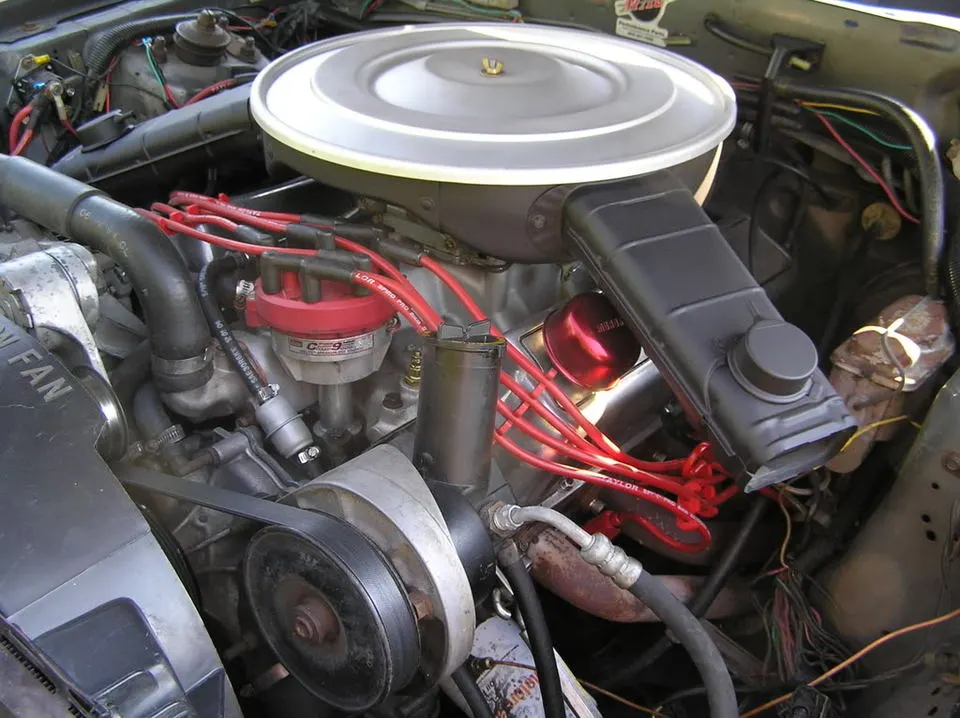

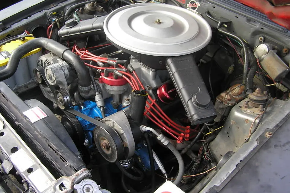

Do what i did....build a 347, put on iron heads, paint the block/heads all the same color...don't spice it up with flasy parts. In the end nobody will know unless you tell them.
Check out these before and after pics:
Before:
After:
Even the well trained eye of a Mustang fanatic wouldn't know the difference. If i didn't paint it, it would've been even more low key (hell give it 20k miles and you won't know the difference). It just dynoed 362hp/364tq at the wheels....i don't see that happening without stroking the engine, or at least without building a stout short block that can run high RPM and running a healthy cam...but the problem then is that your heads and intake won't keep up with the cam.
