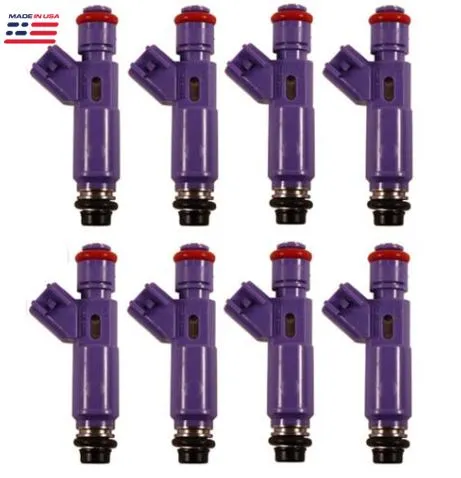

What ECU are you using? Are you using these 24 lb purples or something larger?
