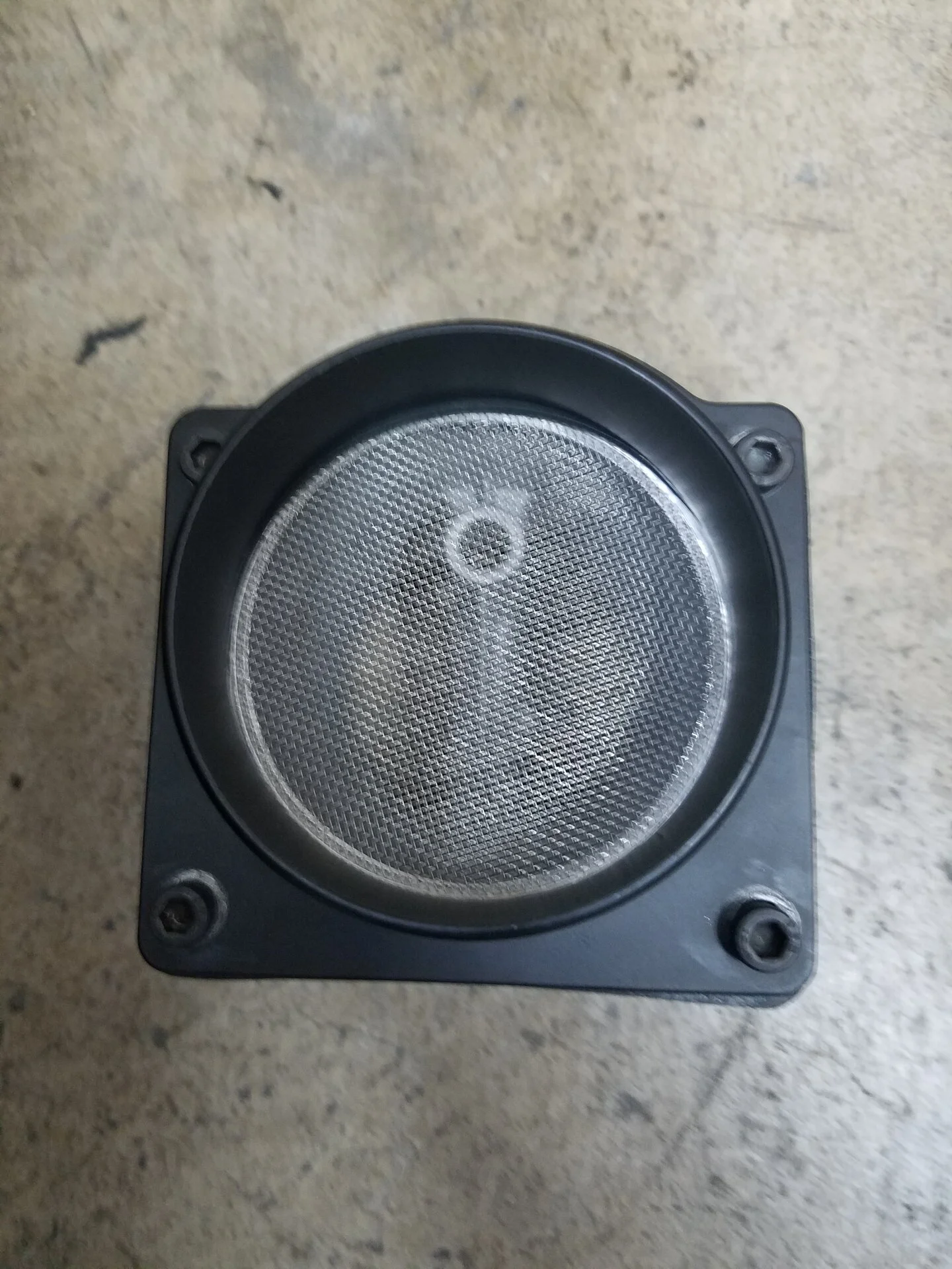

not to hijack this thread.. I have a 95 mass air meter on my 89 Ford Mustang 5.0 5 speed Factory air box with a K&n drop in air filter I'm not running a mass air meter screen right now but after reading this I will be putting it on I have the mass air meter screen from a 95
mine's nothing fancy but this is how my came out
