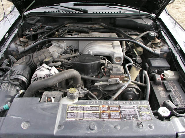

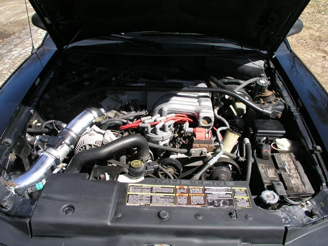

I don't completely agree with that. The factory intake is pretty restrictive. Just look at how it makes the sharp bend with the corrugated rubber tube.
Versus:
It might not make a difference on a stock engine, but as soon as you do an H/C/I, you've just got to start tracing your points of restricted flow.
(appologies for my engine compartment being a mess, still working on it)
Versus:
I can't even tell you how much I agree with you on the factory S-bend black intake pipe.
The first thing I wanna say about it is .............. IT SUCKS
I won't go into a lotta details but I got this engineer type friend who designs car ac systems and works with airflow in pipes, ducts, box enclosures and the like.
I told him about wanting to make a home made cai and he asked to see the stock setup on my car. He then offered to test the airflow of the stock system and then test the hm-cai for a compairson.
We tested air flow through the pipe only on each system and the stocker was way more restrictive than the straight piece of 3" pvc, no surprise there.
We then tested airflow through pipe, maf, & same K&N on each system and the gain in air flow was just over 25% on the hm-cai.
This was over 5 years ago so I've lost the data we got but anyway I thought you guys might like to hear about it.
Later
Grady
