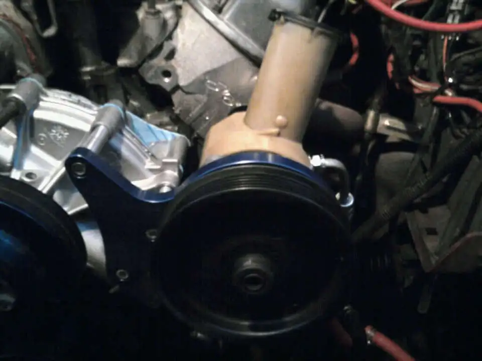

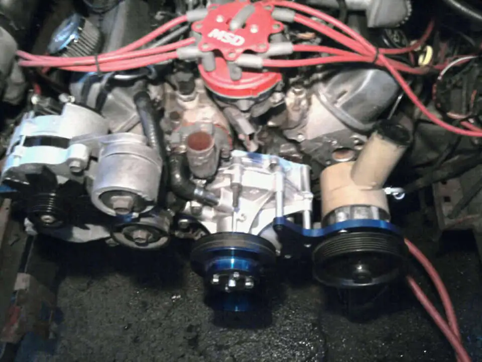

Here is a couple of pics
Close up
Well, like I said, if you go to AutoZone or Advanced or O'Rielys, its the same pump between those two car models, so if you get it there, you probably will have the whine until you find the cause. Have you greased everything under there and checked for binding? Outer tie rod ends and ball joints. If the pump is working really hard to assist in turning the wheels, it will whine alot. Like I said, I used that pump, but replaced pretty much everything (except the PS cooler). You may want to flush it out completely and try again with fresh fluid... also if you are getting metal flakes, they are coming from somewhere.... can only be from the rack or the pump in that system.
