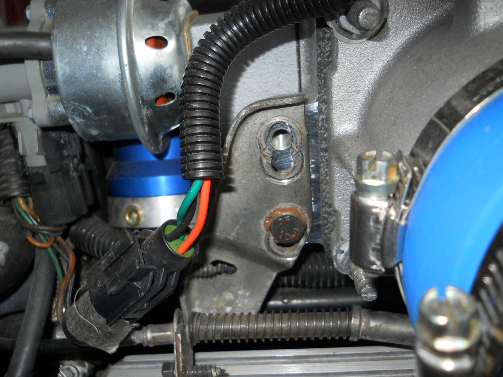

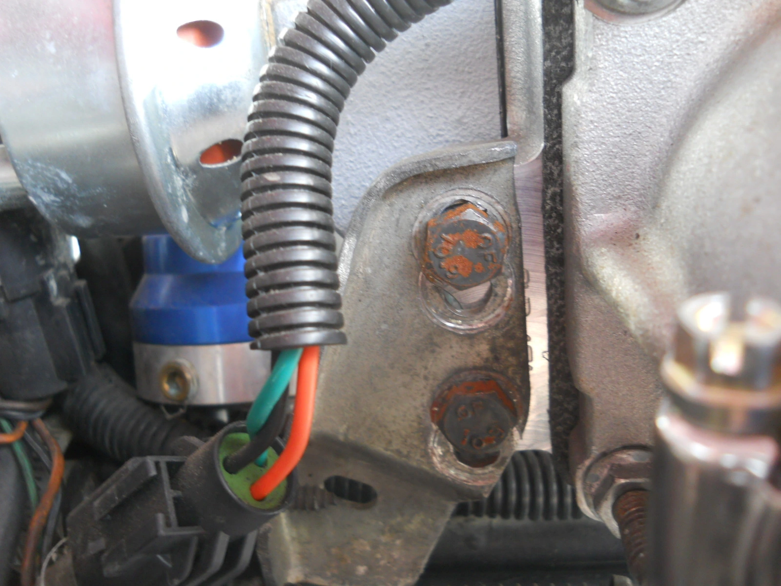

Larry, Can you take a pic my friend just to see how much it needed to be elongated as well. That would be FANTASTIC!!!!!!!!
Thanks again, Ant
here is one I can snap another with the bolts removed also if this pic does not help. Good Luck!!
Hi Larry, Thanks for the help, pics and everything! It was a great help to me!
One thing though, Im sortve lost on your PCV set up! Right now, I am currently running an oil separator on my stock PCV set up. and it goes from PCV valve to separator to Upper Plenum in the stock location, (which would be the underside of driverside back plenum) Im running a 90 degree brass fitting and it clears on the shorter EFI v/c'c. But When i add the Tall V/C's, i have to remove this fitting due to clearance issues and plug it with a brass plug fitting. And then running the PCV hose coming from separator to the front vacuum port of the plenum,actually the spot opposite the stock vacuum tree on the underside of the plenum. Are you follwing me? Do you think running it to this spot would cause for concern? Because the FORD engineers mustve thought the original stock PCV vacuum location on the plenum was perfect, But running tall V/C's and GT40-i have to make it work, its not ideal... Just wondering if running it to that location would be a problem... What are your thoughts????
Thanks for the pic, if you can take another w/o bolt, would be ideal!

Thanks for the pic, if you can take another w/o bolt, would be ideal!Here is another to show how I enlogated the bolt holes. Also I should mention I did grind some of the bottom of the bracket off too.
