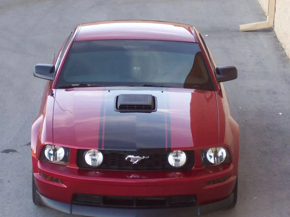

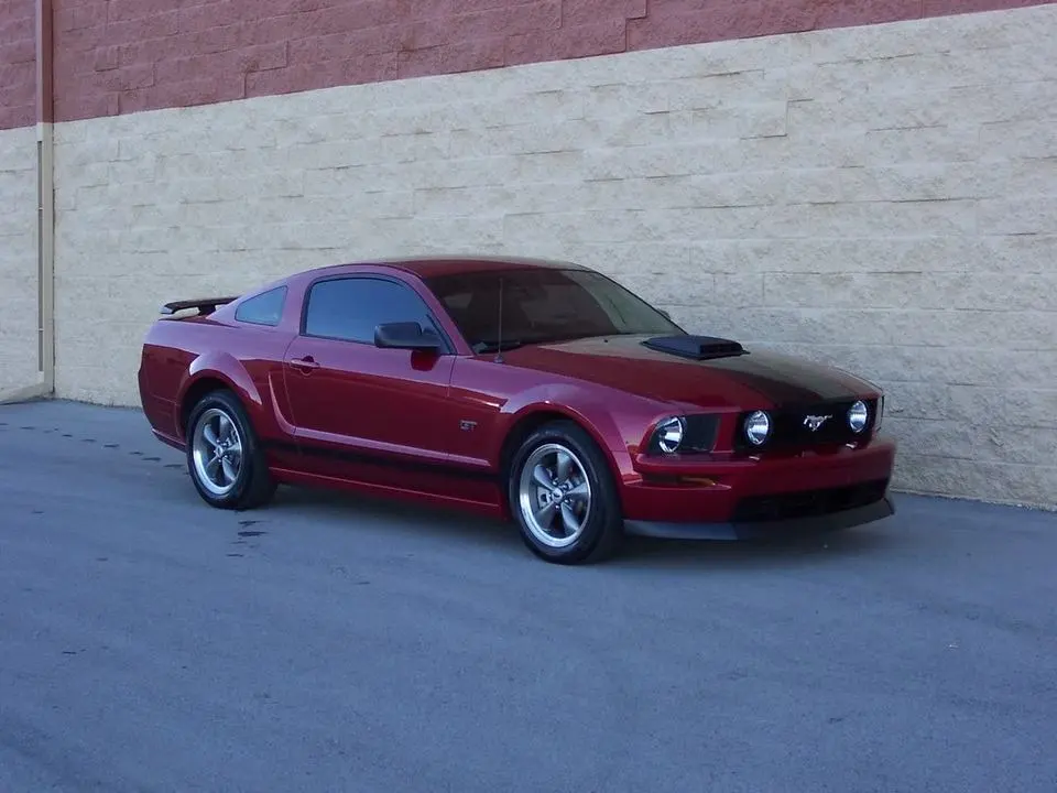

I did mine myself took all of 2 hours to cut and install shaker, it is not hard if you are mechanically inclined.
