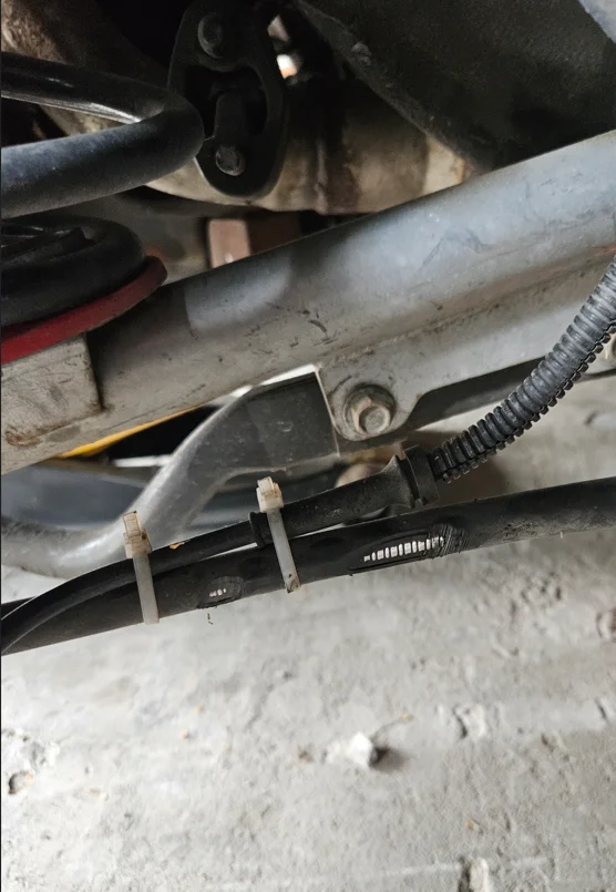

I found that the e-brake cable was rubbing against the tire/rim causing the intermittent grinding.
I secured it closer to the LCA with a few zip ties.

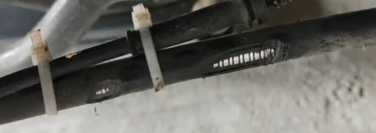

Should I be concerned with the exposed cable with the rubber missing? see pic

At some point it will corrode and bind/fail. They are relatively cheap and much cheaper than a rollaway incident for a failed ebrake. I'd replace. Others will say run it till it breaks but my luck is always it'll break on a hill and be gone.
thanks, i've still got the bracket,
How are you all addressing the ebrake and abs cable after an aftermarket LCA install (other than zip ties) It's too far from the LCA to use the stock bracket and i think i wasn't able to mount the bracket
