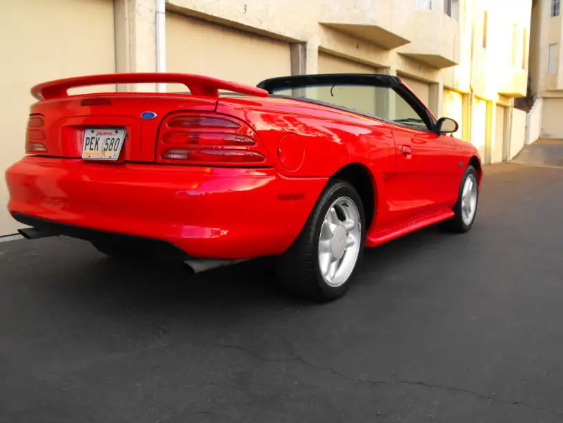

If your decklid does not have a brake light built into it, its a cobra.. This is one of the most suble, but absolute dead giveaway.

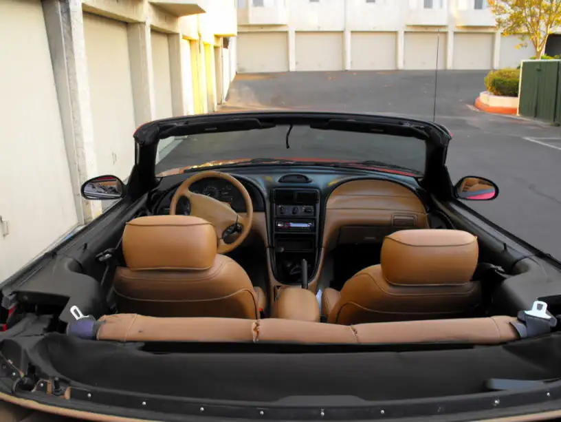

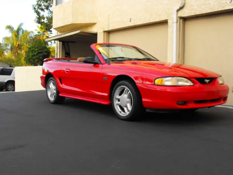

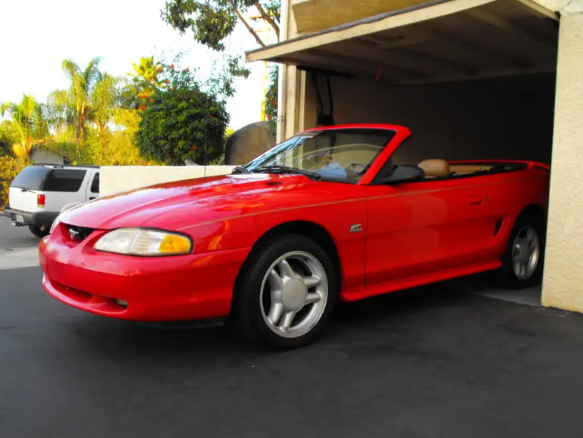

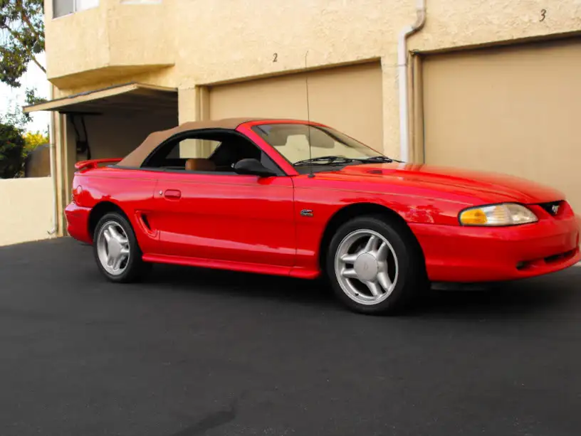

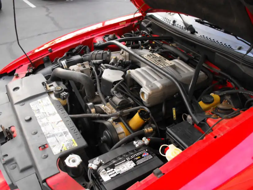

Here are some pictures of the stang. Yes I know it doesn't have a rear view mirror, my 2 year old poled the old one off. I'm trying to find some 03-04 cobra seats for the stang because the leather is dried out in the front seats and top of the rear seats. As you can see it's not a cobra.
