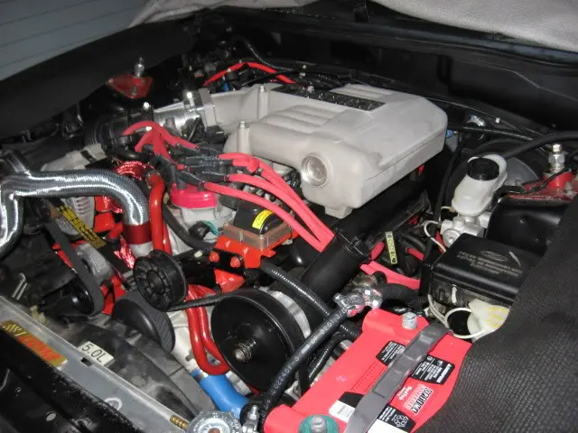

Here's a photo of a "stock" Cobra engine. I have prettied it up a bit tho.
That upside-down "U" is the Cobra-specific oil cooler, it runs coolant past a special block between the engine and the oil filter.
