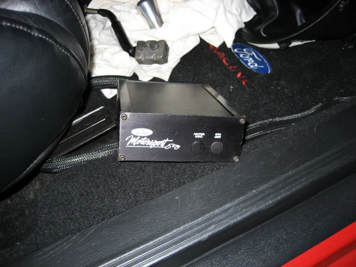

Ford did add the timing retard to aid in warranty issues on trannys. Then SVO made another magic box to get around that. The RPM Extender, it removes the shift retard and lets you adj the AFR and Rpm limit. I scored one years ago and installed it to get rid of the shift retard feature. I run my 331 on the stock computer so they will and do work fine. I won't say it's perfect as mine could use some idle help once the cool weather hits, she likes to surge for a few minutes til you get some heat into the motor and a chip is the only thing that'll solve that. My FTI cam is only 110 LSA as well and might pull 12 lbs vacuum at idle, which hurts the idle. lower the vac, more surge in your idle.
