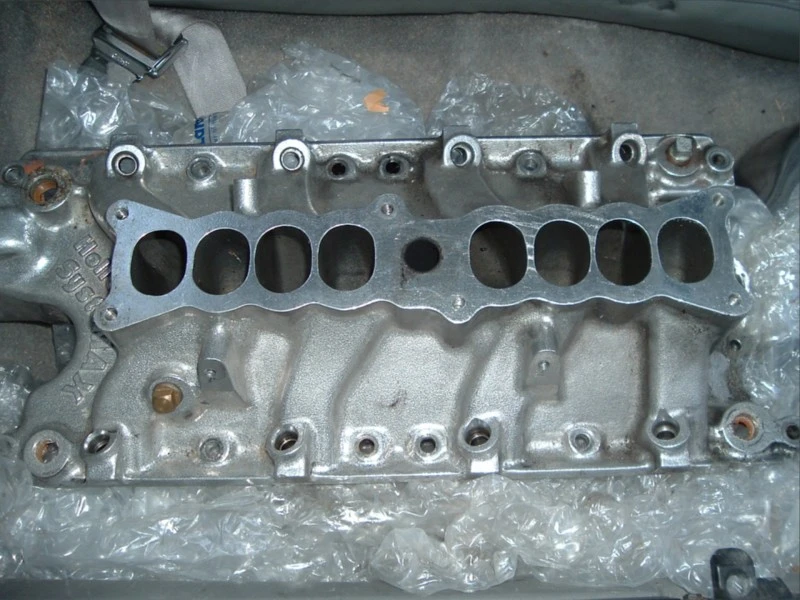

Could you post a pic of this? And does the stock Cobra have this port?
Yes, the stock cobra has this port ibelive. I know my svo motorsports does, and its the same thing. If you look where the number 5 runner is (looking from the front. second from the front on the right side), there should be a plug, you can replace the plug with it.
in this picture, it is just below the leftmost port. there is a brass plug in it.
