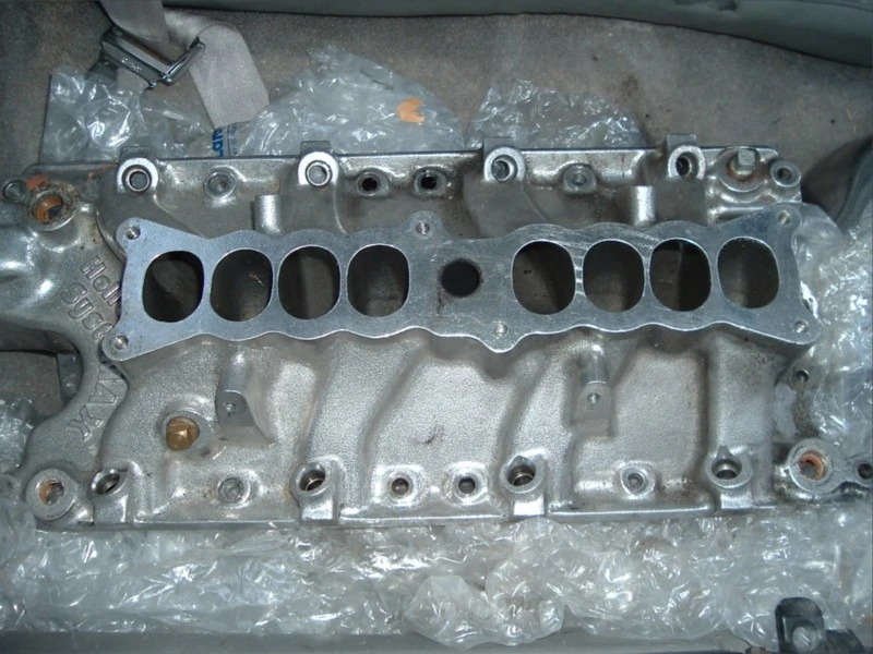

BlackVert said:
in this picture, it is just below the leftmost port. there is a brass plug in it.
Isn't that a stock lower manifold. He has a '95 Cobra so there won't be a hole in the #5 runner. He will either have to drill it or buy a '93 cobra lower or I believe the explorer lower's should also have the IAT fitting in the manifold. The GT40's as well have it.
Nope, it's a Holley SysteMAX, you can see the name on the front, but it takes a stock gasket and has bolt holes in the stock locations.
I'm just relaying info I have learned here on this forum. Don 95Vert knows his $hit and he says moving the IAT to the #5 runner is the right thing to do for ppl with KBs. I believe him.
