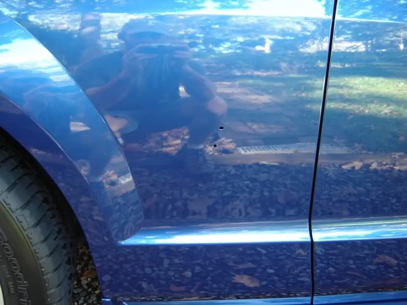

I want to know, is there a hole behind the GT badges on the front fenders of the car (just ahead of the doors)?
I just saw a new V6 with no badges there whatsoever, and no hole, so I'm guessing that Ford would be too cheap to have different quarter panels just for the GT, but has anyone removed one of these badges to look?
Maybe only the 08's have no holes there?

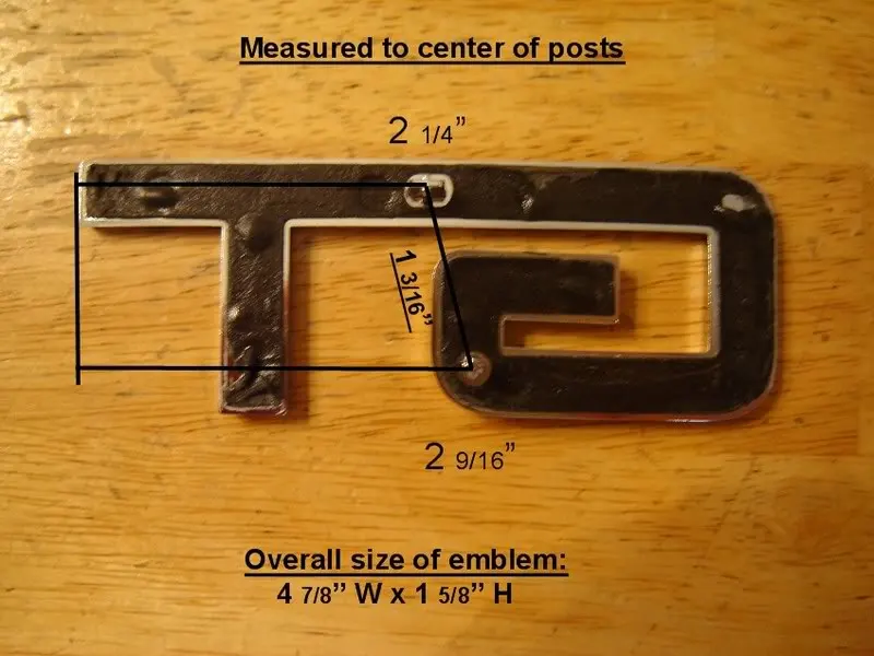

These might not be exactly correct, but very close as I measured them myself.
