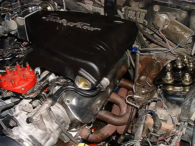

Is there enough clearance to run "Tall" valve covers on a EFI stang?
i run 4" or so tall VC's with a TFS track heat and 3/8 spacer.
I have the Ford Racing 3 3/4" tall polished valve covers with a one "spacer" I have a 1.5" mach 1 hood but it would still clear even with the stock hood as it is below the hood line. I defanatley neede the 1: spacer because even with it in it was a real tight fit, thank God I did not get teh 3/8" spacer. That would have been one more wasted money part :)
