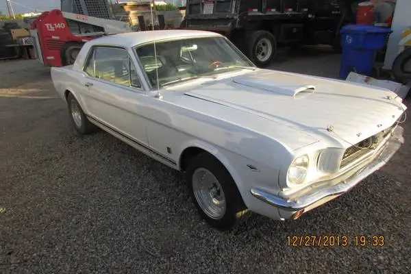

Hey everyone! This website has been super helpful and I'm really glad I found it. I've wanted a classic mustang ever since I was 16 I'm 30 now and I finally have some cash and the time to put into a project car. I would LOVE a GT. I found this one and was wondering if you guys could help me see if it's a real GT. The car is 5 hrs away from me so I want to make sure it's what I ant before I go all the way over there to see it. Thanks for the help!

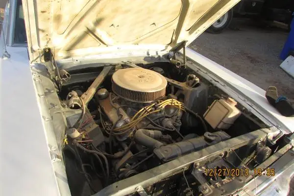

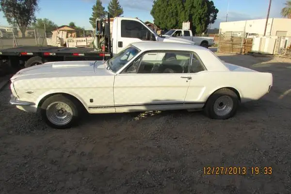

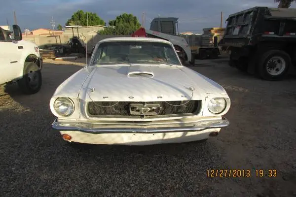

A true GT will not have holes welded in where the quarter ornament should be .
It will have extra holes in the radiator support at each side for fog light wires to pass through. It will be an A code or K code for the motor. It will have reinforcement panels under the rear seat to support the duel exhaust with two large studs coming through with nuts ,that would be the exhaust hanger .

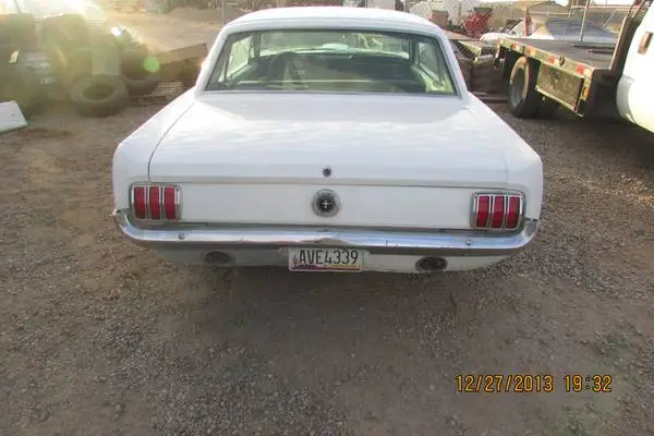

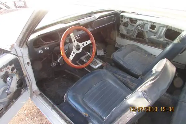

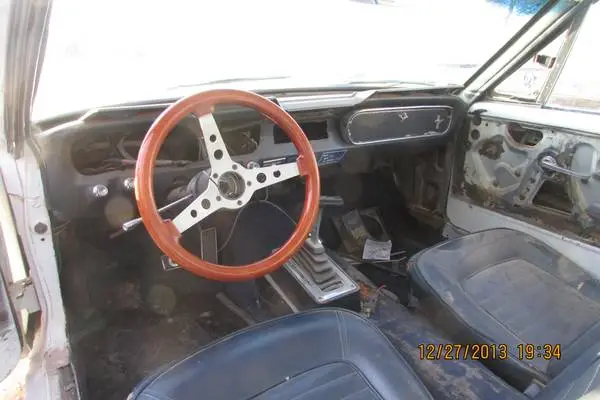

I can see what looks like a disk brake pedal ,you can clearly see the ring in the pad and it appears to have the large disk brake master cylinder ,that's a good thing .It does have the exhaust trim rings in the rear valance . The gas cap is wrong if it is a 66.It doesn't appear to have deluxe interior ,but deluxe interior was an option. It looks like it has a mix of 65 and 66 parts such as the 65 gas cap and the 66 glove box door. I cant see a fog light switch under the driver side of the dash but it could have been removed. it looks like it has a 65 grill so the gas cap may be correct if the car is a 65 .

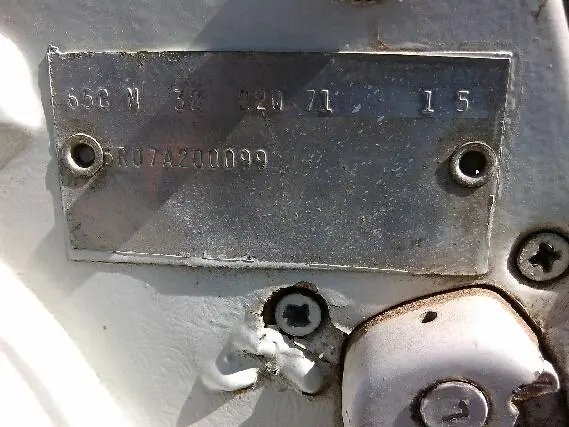

It is an a code so it is possibly a GT. 6k is pretty high for no interior. The hood scoop is another downer because you will need another hood.
65C shows hardtop standard bench seat. M shows as Wimbledon white
32 shows blue bench seat, 22Q is 22nd of march. 71 is DSO Los Angeles
1 is 3.00-1 gear ratio, and 5 is 4 speed, and that is kind or rare with a bench seat GT or not. still nothing to show it is a GT . I would ask the guy if he would lift the back seat bottom and take a pic. of the floor under it.

Just curious as to why you want a GT so bad? I agree with the other poster about the condition of the car. For $6K it seems to be high considering what you will need to put back into it. The dash has also been cut for an aftermarket stereo. Not a terribly difficult fix but still another thing that needs to be done that, if not done properly you will notice every time you sit in the car. If you are looking for a project why not pick up a really nice 6cyl (lots with much less abuse) and make it your own. If you want a real GT for investment purposes I don't think that would be the one for $6K. I'm doing a 6cyl to 8cyl conversion right now. I chose a 6cyl b/c I won't be de-valuing an A code car by making it my own. If you have any questions on that I would be glad to help out where I can. Good luck.
