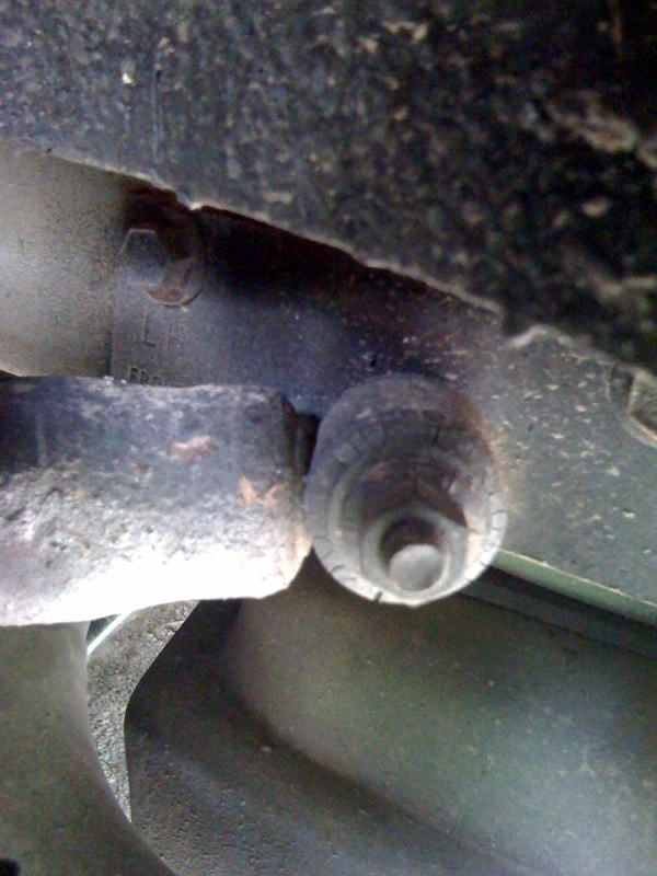

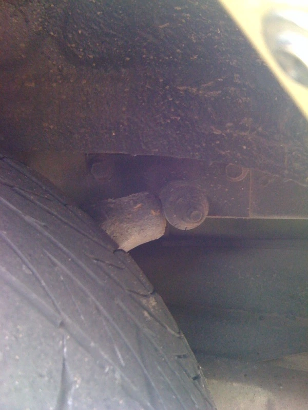

I have a 1996 GT mustang and I've been hearing a squeak everytime i go over the smallest bump. I just had 4 new struts put on which I thought would stop the squeak but it didn't. So I take it back to the shop and the guy points out that my front rotors are warped and need to be replaced. But he also pointed out these in the rear of my car.....but he said he wasn't sure what they were but could possibly be causing the squeak.
Does anyone know what these are? Second pair of struts? Could that be the cause of the squeak?

Leave those quad-shocks on unless you get aftermarket lower control arms. But the aftermarket LCA's can transmit more noise into the cabin. Decisions, decisions, ....

You need a new mechanic...if he doesn't know what those are.
