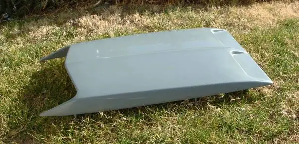

Here is what I am going to do.
1. cut a hole in the hood 13 inches in diameter.
2. Ring the hole with window lace
3. install a 1971 ram air rubber seal on my K&N lid (see picture)
4. install a Cougar Eliminator hood scoop
The seal in item 3 and which you see below will allow air to get to the K&N lid via the scook without the air pressure forcing air up and through the scoop. The seal is available at NPD. I think it is also the same as what the Boss 429 used.
i don't think the eliminator scoop is going to cover the 13" hole, i think 11" or maybe 12" is about all you can get away with. i could be wrong but but i know the eliminator scoop tapers down to a smaller width at some point. so i wuoldn't cut the hole until you get the scoop in hand, if you already have the scoop then i'll just sut the hell up. either way good luck and let us know how it turns out

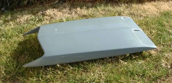

according to the specs for this scoop on MDepot's web site, the scoop measures 26x21-25". For it to taper from 21 to 12 inches would mean that the angles would be steep but the lines seem pretty straight.
I added that scoop and cut a 13.5" dia hole in my hood so the 13" dia air cleaner can stick through. (The driver side motor mount is restrained to keep it from hitting the hood sides during hard launches.) I am thinking about going to the 68 1/2 ram air cleaner setup but the cost is high even for a reproduction set-up.

I like the idea of the rubber seal on the air cleaner. I really need to keep the incoming air cool because my engine runs ALOT better when it's cold. One of the reasons I thought about the shaker idea is that it might give me just a little more clearance under the hood AND it would keep the hot underhood air out of my engine. Your solution looks like it would do both as well. Good thinking.
This is how my hood is set up. As you can see from this picture, the hole does't expose all of the air filter. I could probably have cut it another inch forward, but then I'd have a problem with water running into my filter. Now I can drive in the rain and was the car with no problem.
This is a picture of the filter/hood clearence. There isn't any. Actually the filter is lifting the hood 5 mm in the back. Also, note that the filter nut is above the hoodline.
What I am unsure about your set up is whether you are actually getting any downward air flow through the hood at high speed. The way it has been explained to me by those purporting to know is that the air pressure under the hood at high speed would actually be forcing air up and through the scoop thereby negating the hole in the hood.
