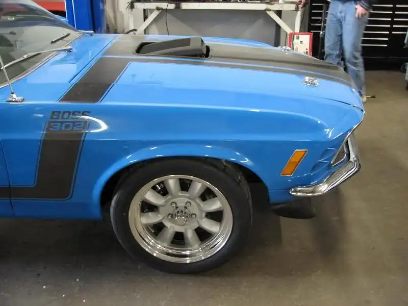

It is indeed off a cowl induction hood. You could just do the same thing and point it the other direction (i.e., the open part facing the bumper) but my idea is to just expose the top plate to the open area under hood scoop while leaving the air filter body to be fed from the air flow coming from the grill and under the bumper.
I do not know if the information was retained or not in the great board wipes over the past few years but I did this many many moons ago, I am pretty sure alot of people run a set up like this in fact, it is essentially no different than the setup used on a 68 1/2 428cj. Believe it or not this was also the option intended for the 69 GT as a bridgegap between the shaker option and no option, many original GT hoods still have the original hole cover with tape on them. I actually posted some of the original blueprints in my gallery at 69stang.com.
What I did was I cut the hole as large as I possibly could and still be covered by the scoop, I used a large base with a standard K&N filter and a smaller top. I bought some weatherstrip form JC whitney that had a square nylon clip on one end and a foam rubber bulb on the other, it clips right to the lip of the base and sticks up just high enough to create a seal around the whole base. Since I was not using turn signals I modified the back rear section of the scoop to vent downward thru the open section of the hood behind the air filter in the hopes that only cold air would enter the filter and hot air would escape up and out the back. It works perfectly fine and effectively but lately I have been considering that the reverse would work better. Even though they are smaller, the openings facing the window and cowl probably have the ability to pull in far more cold air than the front like a cowl hood would and so the heat could escape out the front. This of course owld be a lot harder to fabricate given the short height ofthe scoop to work in though.
I also have toyed with the idea of chopping right into the firewall, removing the snorkel and attaching a ribbed oval rubber hose right to the fire wall for even more cold air, there is no going back easily once you chop into it though and I haven't gotten that brave yet.

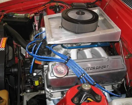

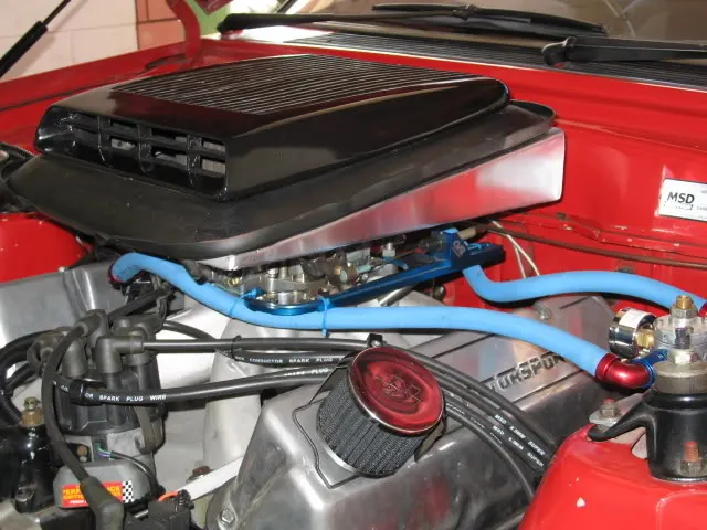

I just stumbled across a great idea courtesy of our Aussie mustang brethren.
This looks like a great idea. Note that his intake seems rather tall. There is hope yet!
