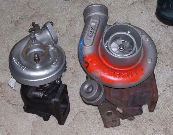

This is a .60/.48 Merkur turbo I have. Nevermind the HX40 on the right :D:

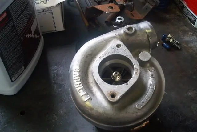

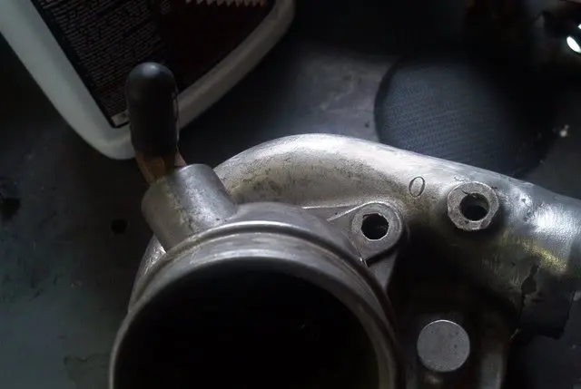

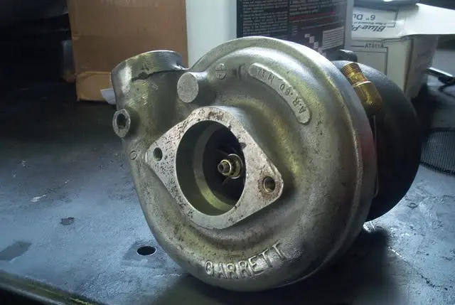

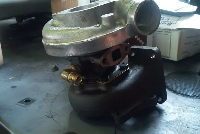

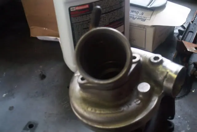

my turbo has just a hose conection no bolts on the compressor but it doesnt say AiResearch on it just garrett and a/r.60 M11. My main ? now is as long as I find another turbo with .60-.48 I should be fine to run them as twins??????
Can you post a picture of your T3? Does it have a hose connection on both the compressor inlet and outlet? The only Garrett-labeled compressor housing I know of with a two bolt inlet and hose outlet like the SVO's is a turbo Buick T3.

I will post pics tommorow and yes its a 302 ranger I am doing. CHEAP CHEAP CHEAP!! need somthing else to play with. There are threaded holes in the compressor inlet adapter elbow that bolts on the inlet side and on the oulet, where the hose would slide on. So I would say yes.
Is it labled anywhere the wheel size? I pulled the housing off and its not under there.
holy s*it bigger then a garrte
Well, that certainly looks like a SVO compressor housing.
Just an FYI, you may have a hard time finding another one of those, as the SVO compressor housings alone usually go for $90-100 (everyone with a thunderbird, merkur or otherwise that wants to put a front mount intercooler on wants those housings).
The Merkur and Thunderbird turbos all have flanges on the turbo discharge, but you can grind the flange down to make a hose outlet like the SVO turbo has (I did that).
Also, I always heard that a .63 turbine was more desirable for a twin turbo 5.0...but I could be wrong :shrug: .48 turbos will certainly be cheaper because nobody really wants them.
That ladies and gentlemen, is a Thunderbird/Merkur turbo that had the compressor outlet flange ground down so a slip-fit tube could be used. It looks like they did a halfway decent job.

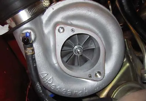

THIS is an SVO compressor housing:
Nevermind the compressor wheel; That housing has been modified to fit a small T4 wheel.
