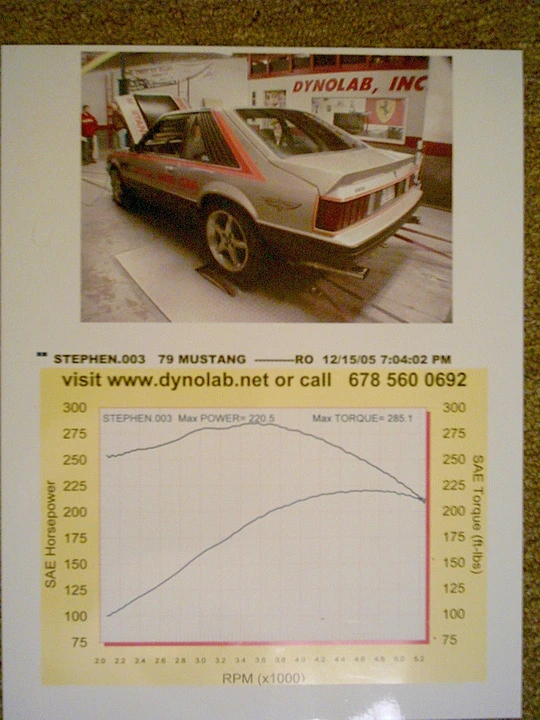

My nearly stock 120K mile 5.0 put 220rwhp and 285rwtq.
All I had were pulleys and a catback.
I'd like to see that dyno chart man...I'm not saying its not true, its possible you have a factory freak. But those type of numbers are unheard of. That means that with the 15% driveline loss your car is makin upwards of 255 hp at the crank. Wouldnt get that with just a catback and pullies.

My car made 220rwhp and 285 rwtq with the only mods being a cold air intake an exhaust. Oh and it had 210,000 miles on it.
Definately believable numbers, I have seen similar from a few cars. But the point is 220 rwhp and 275 rwhp are worlds apart when it comes down to it. And saying it isnt worth it because of the mods, is obviousely coming from someone who has never driven cars making both power numbers!
