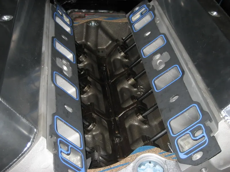

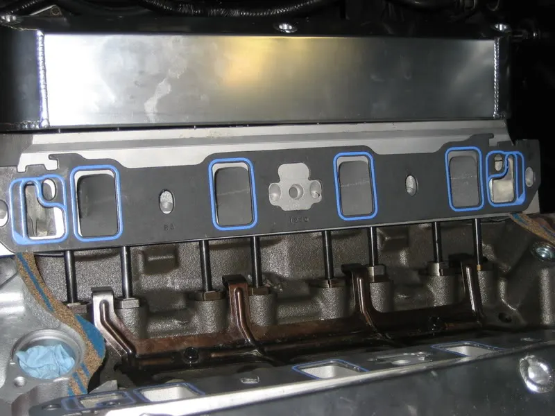

Is this On right??? Putting in on now!
Yobi1Kanobi
Apr 9, 2003
559
Gasket look OK. Water ports OK?
I know you got it installed, but it was upside down as stated.
I hope you trimmed the coolant passages as well:)
Those are meant for the older 351 heads if I recall.
Yes they are upside down
Now for a different method of intake installation :)
I sometimes cut off the part that hooks on the hg to allow the gasket to slide
one way or the other for better port adjustment
If I do cut off the tabs ... I put one little dab of RTV toward the front and rear
of each gasket to just hold it in place until I can lower down the intake
I rarely do use any kind gasket sealer on any gasket
I DO use the cork China Wall gaskets
and
This is one place I do make an exception on a sealer for gaskets
I glue those cork gaskets to the China Wall tops with yellow 3M
weather stripping adhesive
A pea sized dab of RTV in the China Wall corners is done as well
I use a piece of all-thread you find at the hardware store to lower
down the intake to help not disturb the gaskets
I cut off four six inch sections and screw each one in the next to last
hole on each corner
Also ... You need to tighten the entire sequence of bolts many times
until they arrive at an even tightness
Lastly ... after two heat cycles ... You W I L L have several bolts that
did N O T keep their tightness the same as you put them before the
two heat cycles :bang:
Sooooooooo ... You gotta check em again :Word:
Good Luck!
Grady
Not Good :nono:
Little things such as this .........
or
Attention to details ........
Its what allows some put up higher numbers than others ;)
Did you rectify the issue :shrug:
Grady
I trimmed the gasket to match the ports of the head. If i left the gasket untrimmed, a couple of the ports would have been only 3/4 visible. Anyone have this happen?
I did not have an issue once i flipped the gasket. little to no obstruction.
I did not trim the coolant passage.
I used a bead of Copper RTV on top of the cork. I did that last time i put it together and it worked fine.
