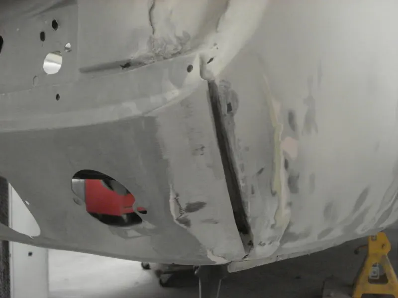

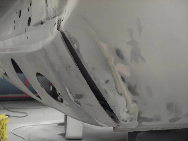

Hi guys, I haven't been around in a while, still picking away at the 65 vert as time permits. I've had more than my fair share of horrific re-pop parts not fitting even remotely close so far but this is before my time. Before I got the car it was restored to some degree by some shop full of chimps so I keep finding new surprises :mad:. Anyway, I welded in a new trunk piece in and while hammering my welds on the drop down panel, near the rear corner, a chunk of filler cracked. After some picking, and then a whole lot of grinding I was left with this massive gap. The quarter was replaced at some time, is this really how bad the re-pop bits actually fit? Not that I would be surprised, it's about what I've had with everything else but still. I'm going to add metal to the quarter I suppose, just wondering if any of you have had anything this far off? It's a good 1/2" apart :nonono:
As far as aftermarket parts are concerned, I can't think of any that fit as poorly as the rear valance. Anyone that can add 3/4" to them would corner the market.

Somebody does it. I bought a repo standard 65' panel from CJ Pony parts and it is a little too wide--wants to overlap the quarters slightly. I guess it is better to have too much than to not have enough. LOL
Actually on mine it was the quarters that were the problem and not the valance as I reused my old valance. I made a patch panel and welded them together with no seam.
Well that's good to know and disturbing as well. I really can't get over how bad everything they re-pop is.
