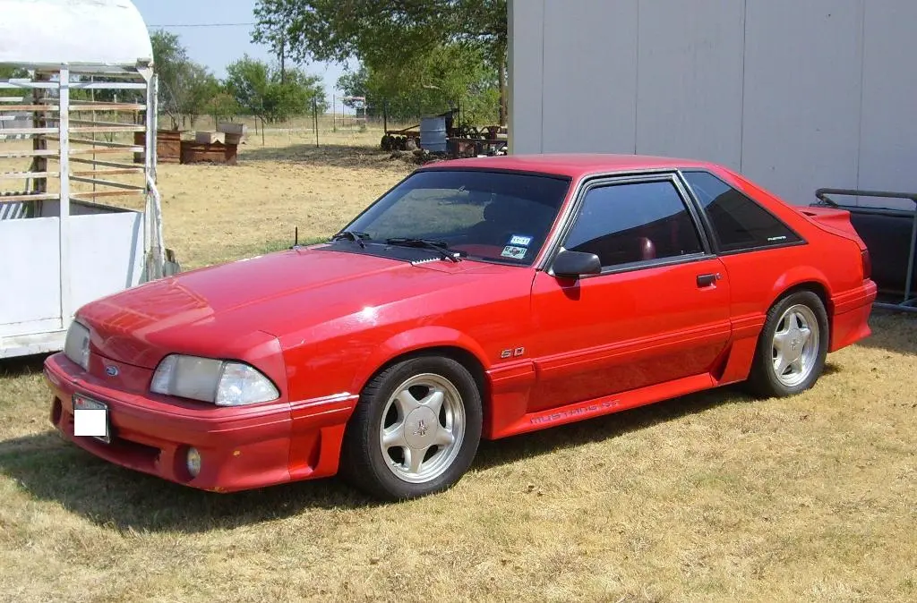

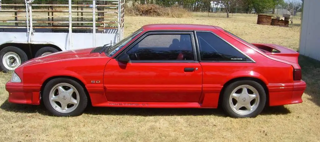

My deployment is almost over and I have started ordering parts for my refurbishment of my 92GT to drive to Alaska. One of the previous owners obviously used lowering springs on this car, and I am wondering if it is too low. I plan on at one point doing a 5 lug swap and putting 17"s on it and looking at it's height now, it looks somewhat lower than alot of the cars around here on these forums.
That being said, should I look for some new springs and shocks?.. Its got 189k on it and I am sure most of the suspension needs a good rework, which I'll do when I yank the motor this next winter, but for now I need to get it to Alaska.
Any recomendations? I plan on getting it to around 300hp N/A only so nothing too fancy to keep it on the road needed. Eyeing the 20% discount at FBworld for stuff on sale.
Looks good to me. Depends on if you like the ride quality or not. Usually a lower car like that rides more harsh. I for one do not mind the harshness, as my fox is not a daily driver and I like the "raw" feel of it. Mine is lowered 2", which most around here do not like.
Get a nice set of rims and that car will look killer with that drop IMO.

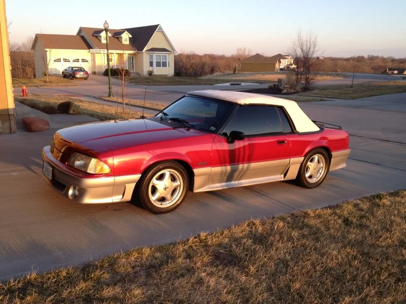

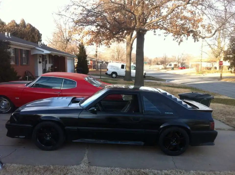

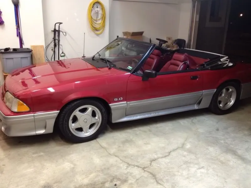

Anybody else with photos of their Mustang that low to the ground with aftermarket wheels? I like this photo so much better in regards to the stance.
As long as you're not experiencing any rubbing when cornering, or "dipping" into driveways or over speed bumps and you can live with the choppy ride, I say leave it the way it is. Mileage shouldn't be your reason to replace suspension components. If it passes a visual inspection (no rotted bushings, or leaking shocks) and you're not getting the "trampoline" effects when you hit a bump, I say leave it alone.
I would however check to see that it was done right. Make sure everything lines up properly underneath. Check the bumpsteer to make sure that the steering rods are parallel. If not, pick yourself up a kit from Steeda or the like to correct the issue. Some guys also/alternatively use rack bushings as well.
Make sure the stock Caster/Camber plates have enough adjustment in them to align the car to spec. If not, invest in some that will.
