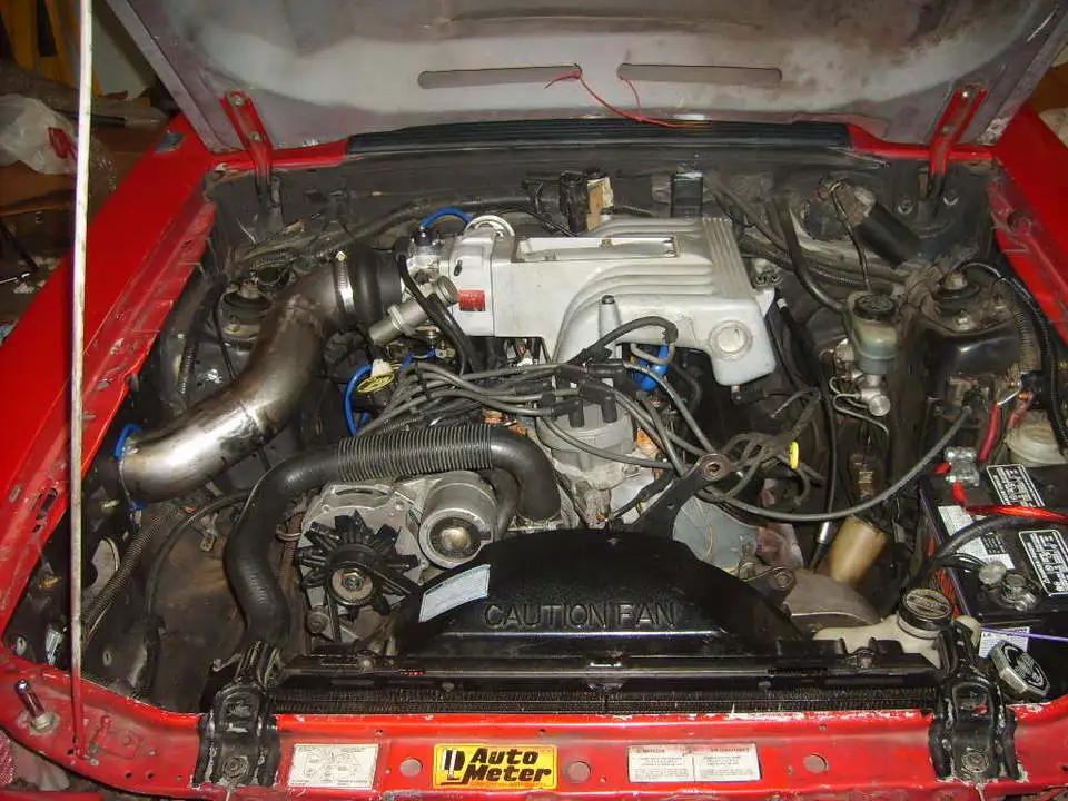

Yeah, I know, you might look at my combo and say "so what?" But this is kind of a big deal for me, I just picked up at least 100 hp (my non-HO was probably making like 150), it's waayyy deeper than I've ever gotten into a motor before, and it didn't some how explode when I fired her up (the cats caught on fire I think though, they were smoking bad enough for a while to make me run and grab the fire extinguisher!).

Which brings me to another gripe about the car; shortly before I fired it for the first time the other day, I noticed coolant leaking from the water pump as I was filling the cooling system, but I fired it anyways (I just had to) and fixed it that night. The next day, I noticed water trickling from the thermostat housing, so I fixed that last night, thinking it wasn't a big deal because I just put the gasket on with no silicone or anything the first time. Today, of course, there was no improvement, and I'm beginning to wonder if there isn't a crack in the housing or something; I sure as hell don't want to have to pull the lower manifold off at this point, so if it's cracked I'm sensing the use of some JB weld in my near future . . .

T-stat housings can be a biotch. Clean the **** out of the surfaces of the intake and the housing. I usually get a gasket, silicone it with the T-stat to the housing, let it tack up, then put some on the intake and bolt it together. I let it sit for at least 12 hours. I use RTV Ultra Copper.

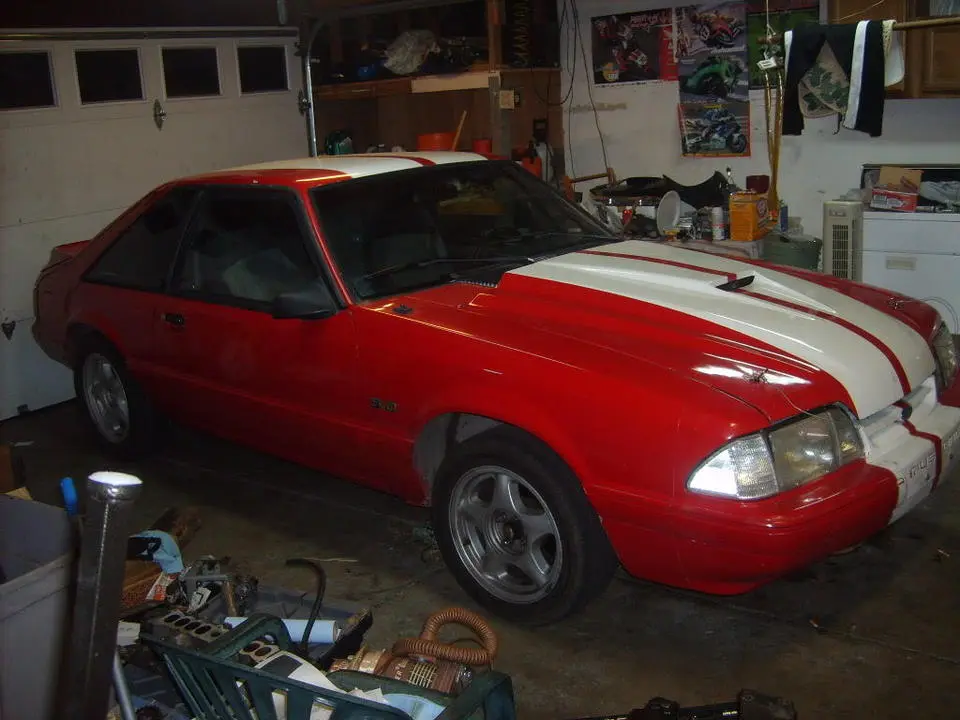

She doesn't look too bad either. You'll always love 'em, but they're always a PITA
Hehe I showed the "good" side; the driver door is dented in and lacking an external handle, and the passenger interior door handle is broken. Both of the seat brackets are broken; the driver seat only has 2 bolts holding it in and the seatbelt is tied off because it doesn't retract :eek: so I have to take it slow for now 'cause I enjoy not being dead. The fuel level gauge doesn't work, neither does the oil pressure sensor (though I think that'll be an easy fix) it just goes on and on hehehe . . . . :nonono:

Great progress so far man, you have a Stang so you are already light years ahead of me. Sounds like you have a good handle on things and will get it worked out though. T-stat housings are the worst on these cars and had me fight it for a few days too. RTV'ing it to the housing is the best way to do it but you really need to let it cure overnight before adding coolant. That was the only way I could get er done :rlaugh:
Dont forget to burp the air out of the system. Try to have the nose a little high so the air travels towards the rad fill. :nice:

I didn't have a gasket and I wanted to knock it out last night, so I just used a bunch of RTV red silicone; I dumped some water on then let it set up for a while before putting it back on, with the water it tacked up real quick, in fact I started the car maybe less than 7 hours later and presto, no leaks. While putting it on again for the third friggin time I noticed that the clamp on the heater hose was interfering with the housing; this probably caused the bad seal the first two times, no idea how I missed that.
