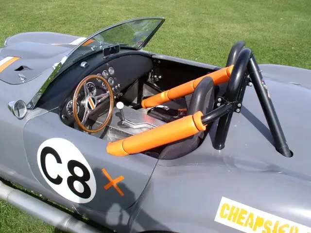

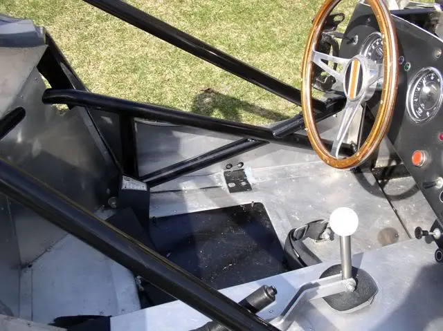

Been racing Cobrask8 very hard, new roll cage, motor mods, it's just about a full racxe car now! Did 145 on Sat a few times on the front stretch.

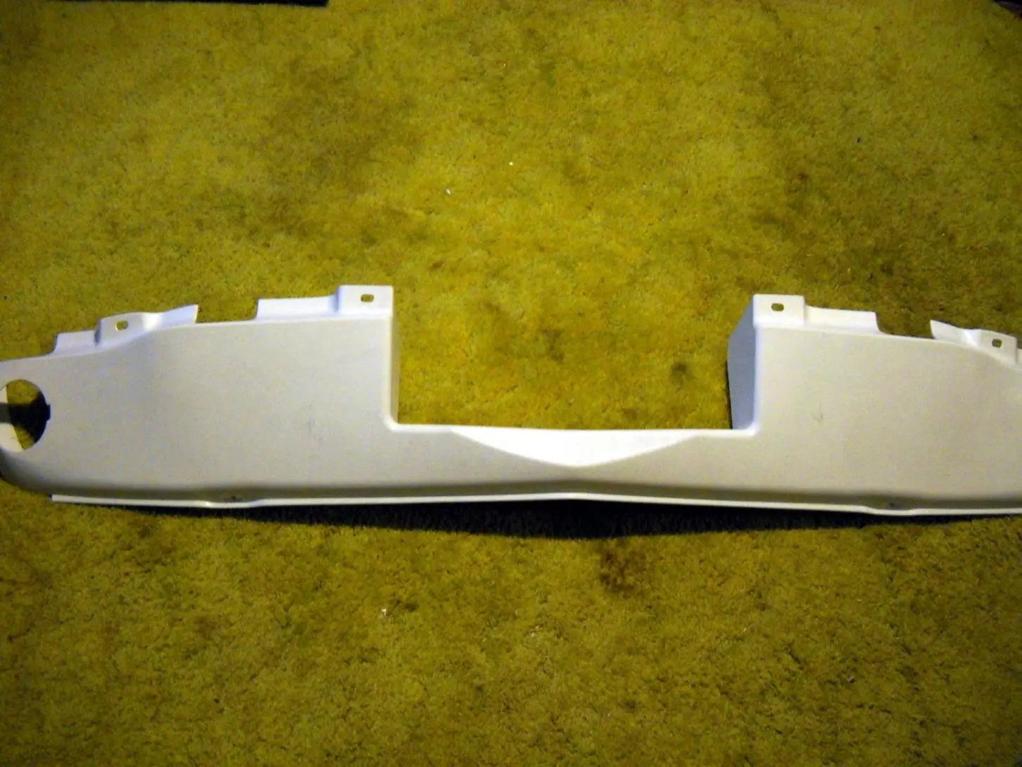

I have sally's new "nose" (GT350R style front valance) and subframe connectors.....

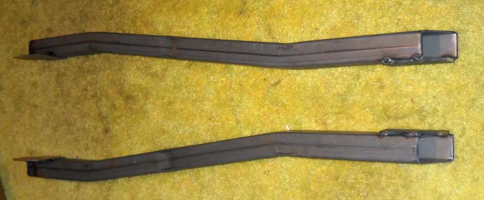

The prep work for the subframe connectors is done, just have to do the final fitting and wellding, going to get that and the final weld up of the rocker panel done this week...(I hope!)

I got these from Tinman Fabricators, made specifically for The '65 stang and very simple installation.
First you cut open the end of the front subframes, slide the connectors into the front subframes the conform to the floor pans and meet up with the rear subframes just in front of the rear spring mount.
Two 1/2" holes on either side of hte front rails for spotwelds, weld up the frames.......
