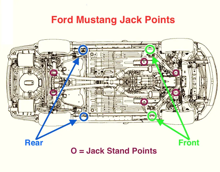

It's hard to believe that someone hasn't posted an image of the hacking points yet.

I saved the above photo/diagram to my desktop before realizing that it is Not an S550.
