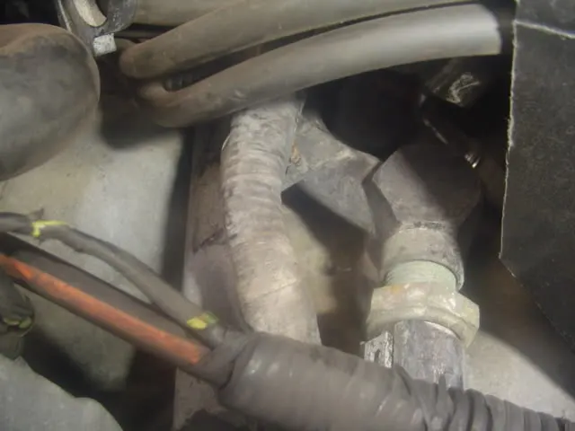

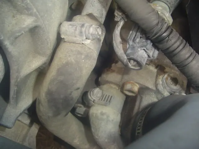

I am mistaken in my above post. There are 2 steal tubes that run to the rear of the engine where hoses connect them to the heater core. Up front one tube comes to the front and connects to the water pump and the other gets threaded into the intake manifold on top of the water neck housing area.
On the rear, when looking at the firewal, the left hose connects to the bottom tube and of course the right hose connects to the upper tube on the heater tube assy.
here's the best I can on pics:
This pic shows where the hoses go from the water pump:
This pic shows where one heater tube terminates into the manifold via threaded fitting:
And this pic shows the hoses connected to the rear of the heater tube assembly:
