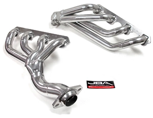

I have JBA mid length headers on my 65 with 302 and T5. I have a Modern Driveline clutch cable. Everything works nicely. I would definitely recommend the JBAs. Since you have a 351 there will be a slightly different fit, but I would think you should be ok.
That part number must be MU's part number. I don't see it listed on JBA's website.
By the way, I don't care for Hedman. I have seen too many with defects like pin holes in the welds.
JBA lists the 1655S for 64-70 Mustang 351W with cable clutch.
That driverside header looks weird. I wonder why it has extended pipe to move the ball flange down. The ones I have for my 302 don't do that.
