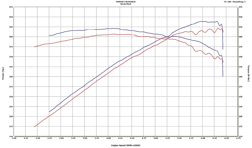

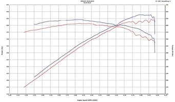

First off let me say that the only mod added between the two runs displayed below were a set of the JBA 1625-7JB's and an AFR adjustment in the tune to compensate.

UM, so that dyno is showing a gain of almost 15rwhp with the shorty headers? :shrug: Thats nice if so!
EDIT: I just read a few posts up. 12rwhp. damn nice =) I got my JBA shorties for free and installed them myself. Guess that was worth the 20 hour hassle of installing them!! :nice:
