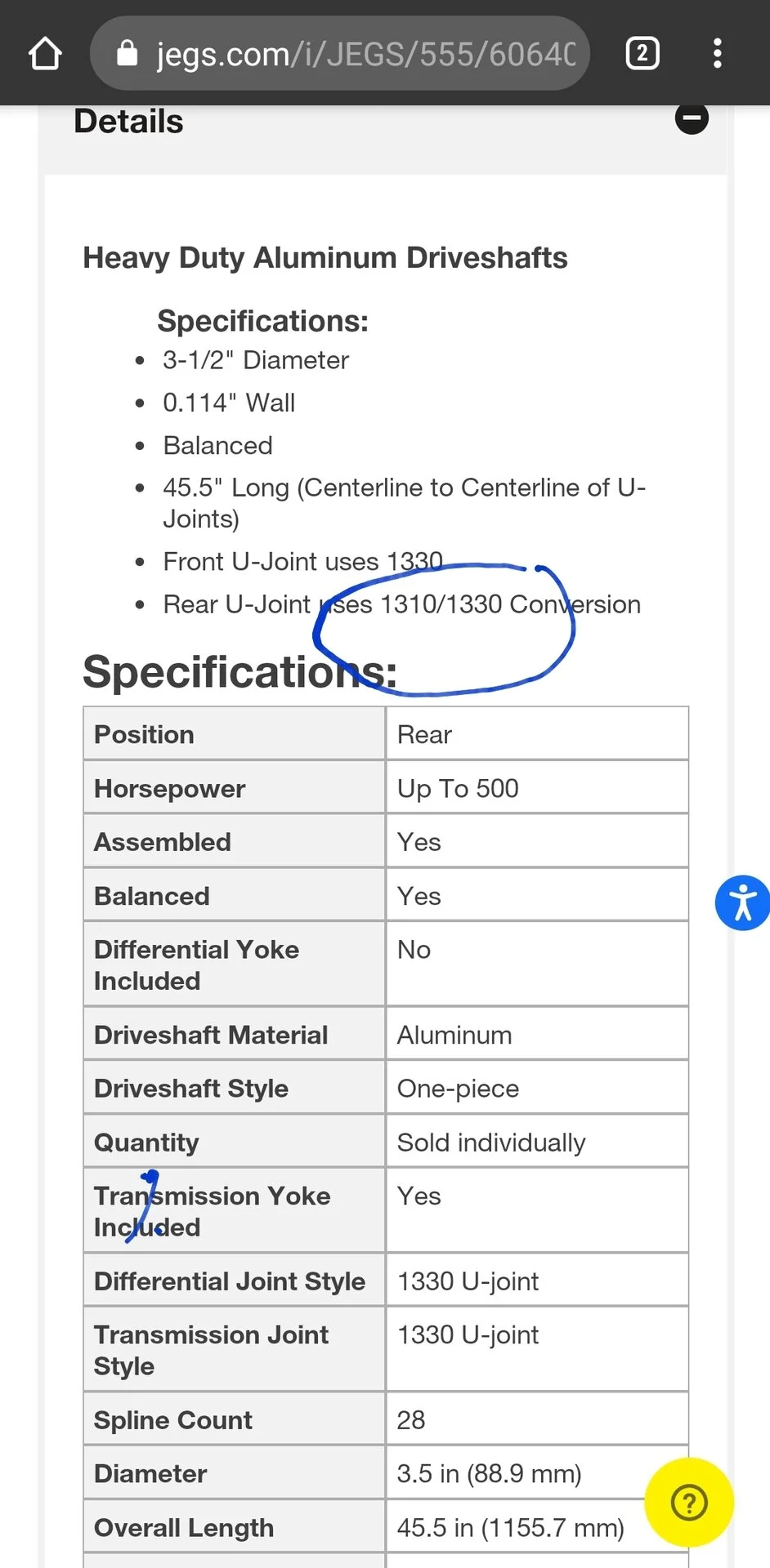

That Jegs driveshaft is decent. The difference is the hybrid universal joint used at the flange for the rear. Its 1310 and 1330. The real difference between that one and the FP one is the flange universal joint is the bigger size. This is also why the Jegs one isn't rated for more hp.
To make it have more power you would need one of the 1330 driveshaft yoke flanges, according to several of my old school friends.
