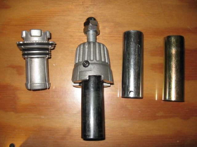

Take driveshaft off rear end and check the amount of play at trans. If the yoke has alot of play then just changing the rear seal in tail housing ain't gonna do.
You'll have to change the tail shaft bushing ( no fun).
Tool to change the bushing is really nice to have but they are expensive. You may put a feeler out on here and see if anyone has one and will loan / rent it out.
This one came up in several threads on other forums with really good reviews:
Other option is to pull the housing and take it to a transmission shop and have them replace the bushing. I would call them before doing any work so you know if they just want the whole transmission or just the housing.
