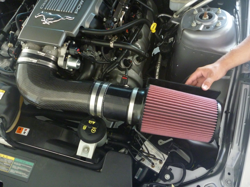

hey yall, longtime listener first time caller. just bought my 4th stang, an 07 gt. ordered a jlt carbon fiber 110mm cold air kit and sct combo from brenspeed. its too late to call them tonight soo i thought id try you guys for help. first the tube was touching the power steering fluid res, then noticed it was too short to use the included heatshield. so i thought i would try running it without the heat sheild tonight. but the hood wont even close. not at all, like 3 inches too tall. it just seems off in every direction... what do yall think? thanks,

Pics:

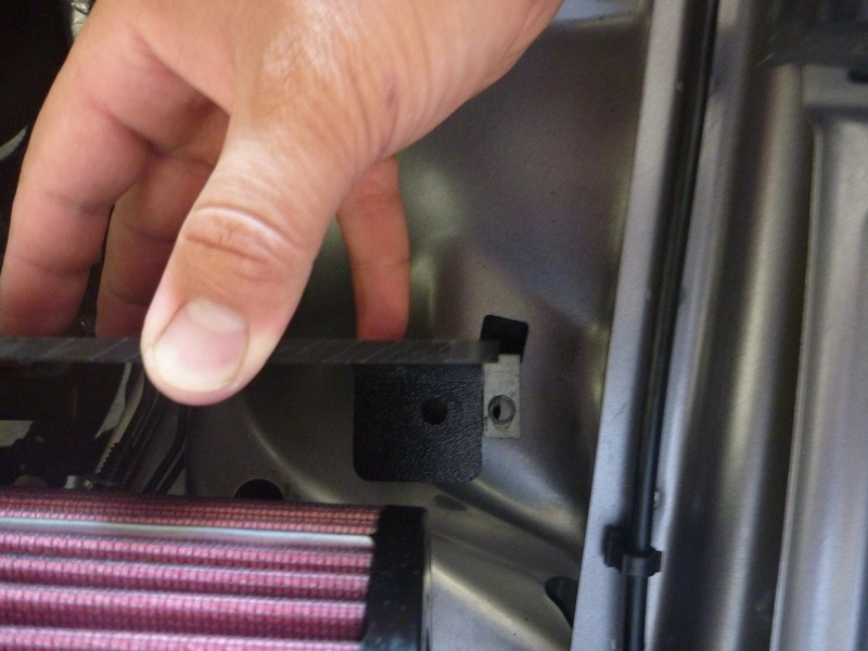

Shield thread misses by an inch short:

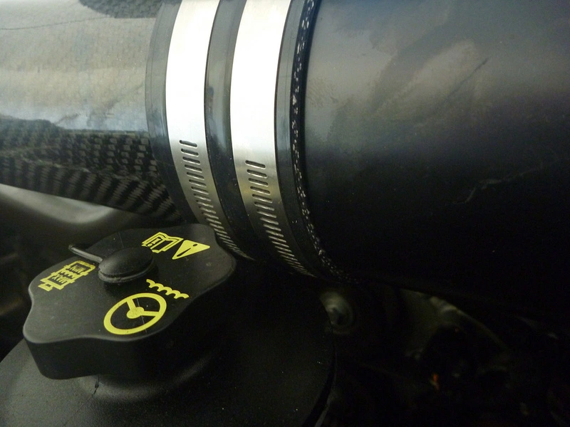

Duct goes over/impedes against my radiator cap, while the pic on Brenspeeds website shows it going beside it cleanly:

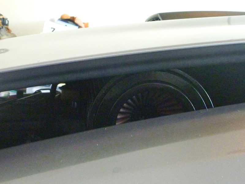

Trying to close the hood, forget about it...

I don't have the 110 JLT but I do have the smaller one and I had to do some minor adjustments to get mine to fit properly. After looking at your pictures, it looks like you need to rotate the intake tube downward, so that it clears the PS Reservoir. You could also try to loosen the PS Res. bolt and push the Res. forward towards the front of the car. I think the reason why the heat shield isn't lining up is because you have the filter to far onto the MAF. Loosen the filter clamp, bolt down the heat shield, then slide the filter back on and tighten the clamp. I think the best thing to do is to loosen all your clamps, position all the parts where you want them and while holding them in that position, tighten the clamps. This is what has worked for me and understand that everything may not be all lined up at the same exact angle (ie, the filter may be slightly angled down vs. the MAF, etc, etc).

Thanks guys, we got it on today. Just had to tweak it far more than we should have. Still have to slam the hood on it to get it to close, which of course isn't right but...

Once Brenspeed techs told me you just have to push/force it into place, it really wasn't so tough. It just didn't seem natural. In fact it isn't a natural fit, the hood still pushes it down nearly another inch or so. And the heat of the air filter mesh melted the hood liner the first day out. I noticed it because there was a plastic burning smell coming form my AC... I'll bet there is a CAI system that fits well, but the JLT carbon fiber model isn't it...
