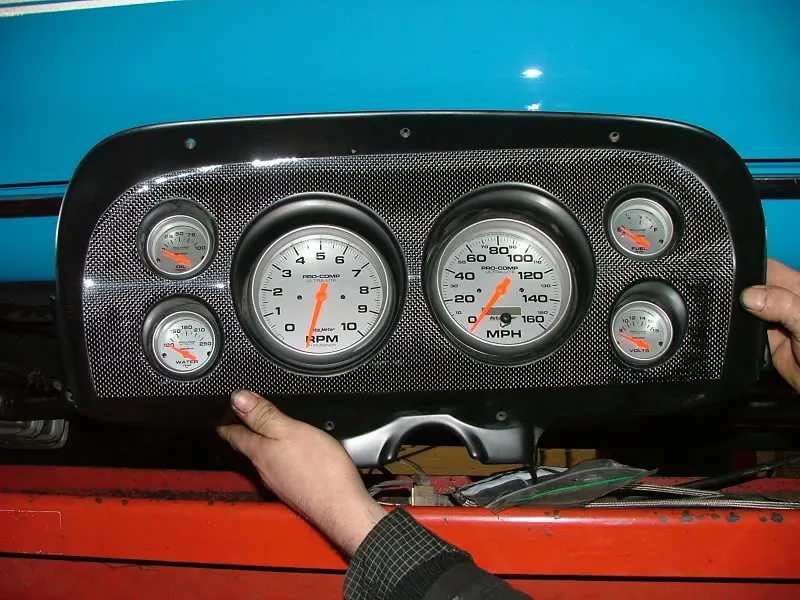

We just installed the Year One with Ultra Lites in our '69. It doesn't say in their catalog nor does it really show, but there are no provisions for turn signals, high beam indicator, or brake (or other) warning lights. Also, it is built to fit '69, '70 needs fitting to line up (they aren't the same). The top needs to be pushed forward about 1/2-3/4" to see the tops of the lower 2" gauges. Overall, we are digging it.
I am using a blue LED for the high-beam, green LEDs for the turn signals (but then I have these on the hood scoop anyway) and a red LED for the idiot light. Got everything from radio shack. These are threaded on the opposite side so you can fit them through the gauge cluster and affix them with a nut. My mechanic says he can put the green leds behind the speedo and tach so that when the lights are on and the turn signals activated, you will see a blinking green light behind the gauge.

I got my dash last night. I am disappointed that it is not textured. I plan to leave it black but will need to paint and texture it first.
No pics yet, we just got it buttoned up Tuesday and I have been working :shrug:. I will get some up soon. we will be at Silver Springs for NPD's roundup this weekend, winter blue '69 hardtop. Speaking of '69-'70 dash stuff, anybody with missing or damaged trim pieces on the outer edge, Virginia Mustang offer good quality repops for $16 a pair.
We also were a little disappointed that the cluster wasn't textured, but the satin finish isn't bad with the gauges installed. We made housings and lenses for the signals and such on ours to use bulbs so we have some control over the brightness, LEDs are just a bit too bright for our liking. We'd be tickled if the vendor making the cluster would offer a matching piece for the passenger side.....

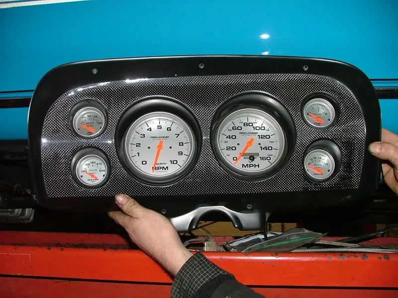

It is symetric (close anyway). The light in the room i took the picture in must have caused the shadow to look a little funky, it does have a "bend point" if you will in the gauge face.
Actually, the pictures taken by two different people and two different bezels show the same thing--the top of the bezel shows a gradually declining line where the screws go into the dash pad.
From the left, the edge of the bezel to the face is a longer distance on the left than it is on the right.
It's definitely not symmetrical, based on that--like I said, it appears to be tilting toward the left.
Take a look at the line I'm describing . . .
that's because the originals are that way as well. it's to make the gauges more visible to the driver by slightly canting them. don't worry it's correct.

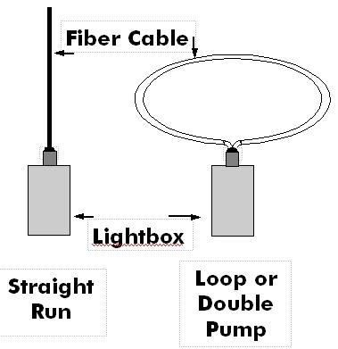

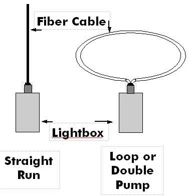

Instead of LEDs for turn signals and high beam, I am thinking about fiber optic cables. We can make a loop (in the gauge, behind the gauge, anywhere really) like this.
