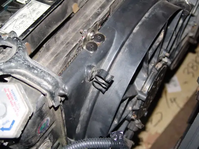

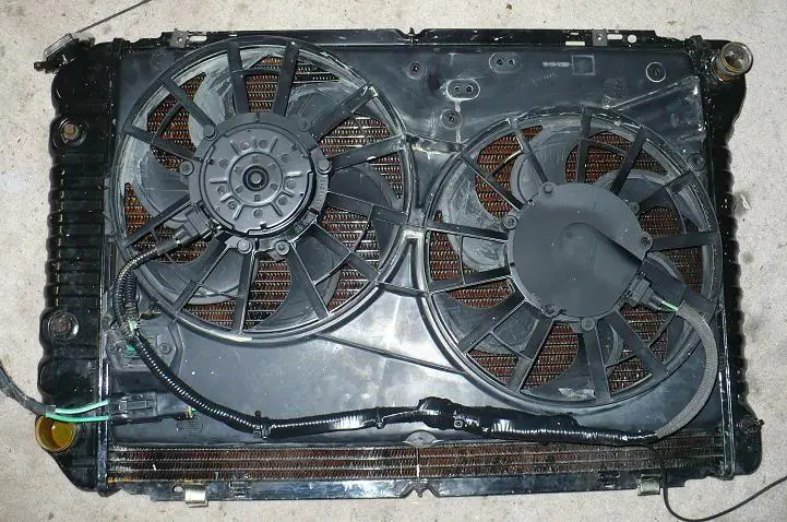

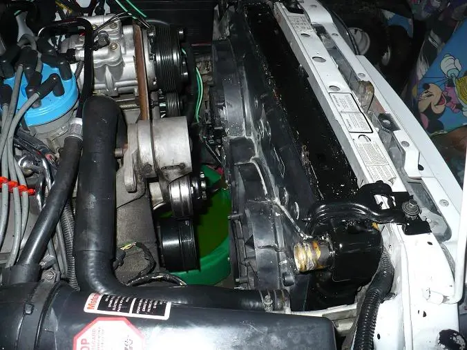

I picked up a electric fan setup from a V6 ford contour for $40.00 at a You Pull It yard.It fits really nice on the fox body radiator.I made some small L brackets on the top so I could bolt it where the stock shroud was And on the bottom I made some brackets to slide in where the shroud did.

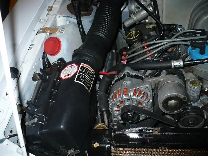

Looks good. Here's mine mounted.

I used a Jegs adjustable temperature control switch part#555-52125 and a 30amp relay.

I used Hayden part # 3654 fan controller. It will operate the fans on both speeds. I also upgraded to a 6G alt.

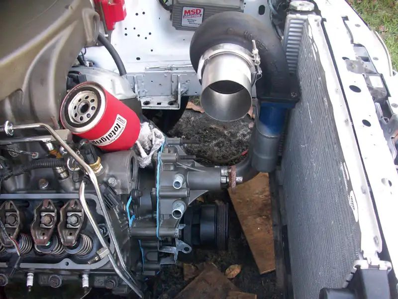

Anyone use a single electric fan? JY or not? Pics?

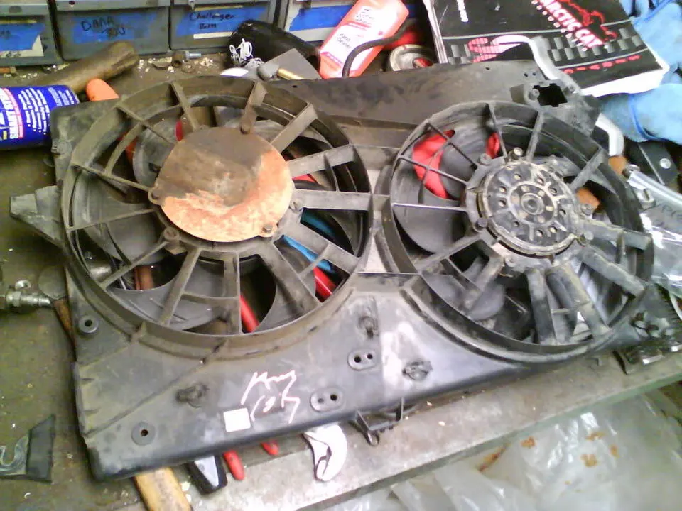

^ Ive got both Black Magic single fan and junkyard V6 Contour fans. Definitely prefer the Contour fans. The Black Magic will be getting replaced soon.
+1 for V6 Contour Fans!!

Arent the taurus and mark 8 fans single fans? I ask this because I dont have any clearance on the driver side of my radiator in between the rad and my turbo so I need a single fan to go on the pass side.
Yes the Taurus and MarkVIII fans are single fans. Either one should fit fine.

The 6G is a later model alternator that is smaller then the 3G so you don't have to grind the bracket to make it fit. It's also wires slightly different. I got mine on ebay. Search this item # 360217957644. It comes with a new/used regulator plug. I didn't use the stock power supply. I ran 4 guage cable from the battery to the alternator. I also ran a 4 guage ground from the block to the chassis. I have a 4" crank pulley so I got a 1 7/8" pulley for the alternator so it would charge good at idle. The pulley that came on the alternator was 2 1/4". I charge 12-12.5 at idle with everthing on and 13.8-14.3 what I'm above 1300 rpms.
I believe the Cougar uses the same Fan set up as the Contour too.
Correct....V6 (2.5L) Contour/Mystique and Mercury Cougars all used the dual fan set up. Some 4-cylinder cars had them as well, but you've really got to look under the hood to confirm for certain.
I've got a fan off of a mid-90's Mercury Mystique on my '06 F150 and it cools the big 5.4L quite well.

Posted via Mobile Device whoever needed turbo clearance, you can't fit a mark 8 fan... I had a guy want to buy one from me for this reason but it wouldn't clear. The taurus fan is smaller diameter but you'll prob still have to trim off one side of the shroud but it might work. As for the contour fan, this is my new fan of choice and what i recommend. I used to be all for the mark 8 fan, which is still much more powerful, but the fit and low amp usage of the contour is really nice. With the mark fan you need a hard to find 80 amp relay which i had to order off ebay because no parts stores carry anything that large. With the contour you can use a simple 30 amp found at any autozone. My buddy even tested his and it only draws something like 21 amps.
Fan clearance......how about turbo clearance.
If that sucker isn't right up against your radiator like it looks in that picture, its damn close. You're going to run into serious issue when that engine starts to twist under torque load.

howd you mount yours?

#18
  • May 29, 2015
  • #18
howd you mount yours to the radiator?
