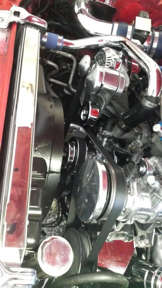

87GT Drop Top said:
Looks good. Here's mine mounted.
I realize this is old, but I was wondering how you had your fans wired @87GT Drop so you could run both low and hi-speed using the Hayden 3654 controller?
