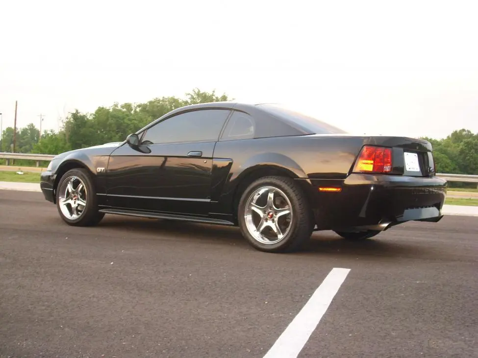

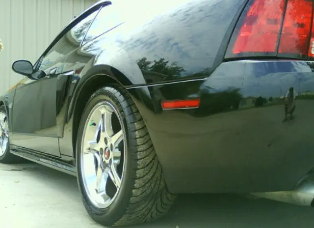

ive got tein springs and i like em. they are 2.25 drop in the front and 2.5 in the rear and you can tell because i feel every thing in the road but hey i got handling like no other and my car is glued to the road it seems. i picked um up on egay for like $180 shipped
before
after
