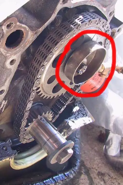

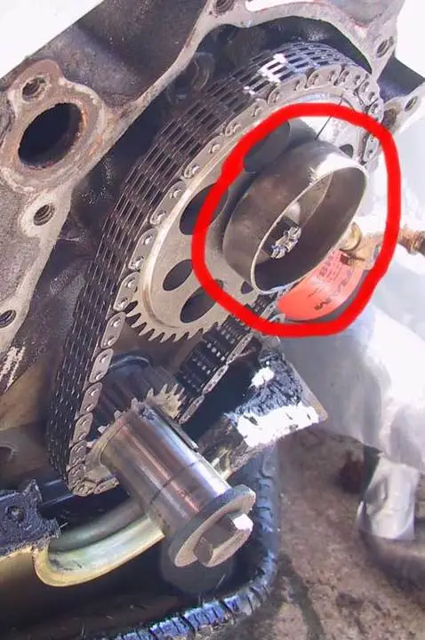

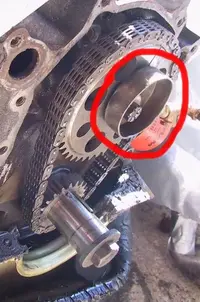

Reason it causes problems is, the 94/95 timing covers are skinnier, because they didn't have to provide clearance/room for the mechanical drive. The drive WILL fit under the 94/95 timing cover only in ONE position. However, IF you put it over, first time you start it, the cam will spin around, then when the drive hits the timing cover, SOMETHING is gonna blow. Some people have been lucky, and their timing cover busts, but other people have ruined valves/heads/cam/pistons/rods etc....
Here's a reference pic of the one I did recently. This engine was out of an 89 FI car.

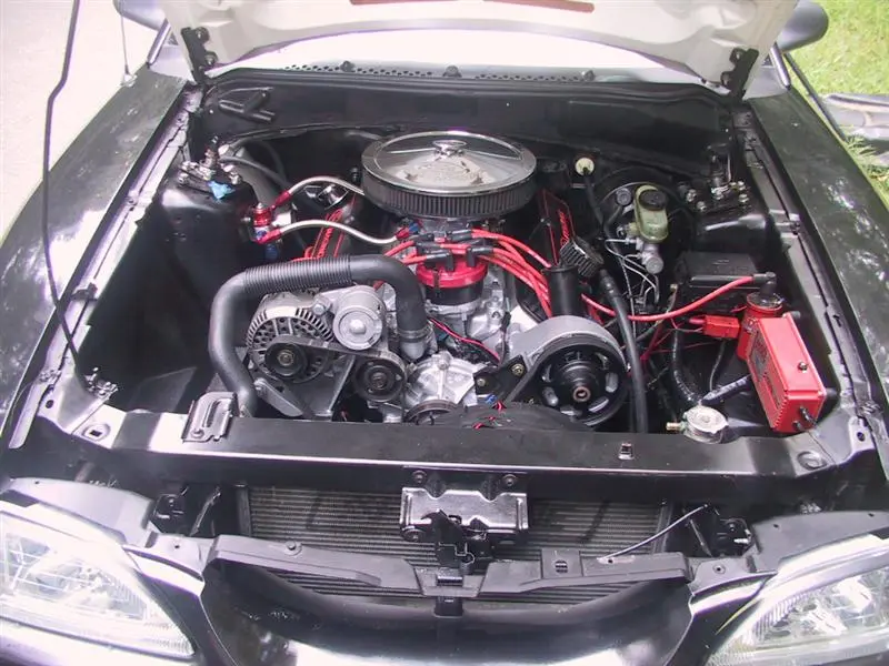

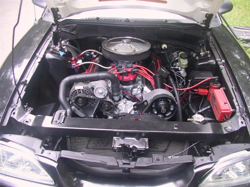

Here's a pic of mine with Fox brackets... You can see how tight it is.
Sorry for the dirty car / bay.

DS is right - it's simple clearance. Foxes have more room under the hood up front so the fuel pump eccentric was left in place on aero foxes. Once they HAD to get rid of it (for the 94-95 nose) they did.
That's a real shoehorn in there DS - I'd have balked at making that work - good job!
