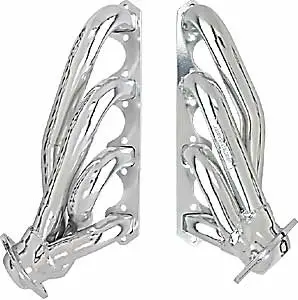

If you are going to buy headers you would be hard pressed to find any better than the FRPP "Jet Hot" shorties. Plenty of clearence for spark plugs, Jet Hot "Sterling" finish with lifetime warranty, 409 stainless steel, 1 peice flange so you don't have to use a "Pry Bar" to put the on.(no offense 5spd GT).

I second the quality of the FRPP pieces - I had mine ceramic coated locally after certain "percussion adjustments" were made so they'd fit my car.
Headers -long tubes and shorties - are really hit and miss when it comes to fit - mostly miss. Without a one piece flange, pry bars are frequently needed - if not when new, then the first time they're removed. With a one piece flange, the flanged surface is rarely flat/true - which is a major cause of header leaks and bolts which won't stay tight. And long tubes more often than not have to be massaged somewhere to clear various bits that they interfere with.
If you want certainty - buy your headers uncoated - test fit them, make any adjustments you need to, then remove them and have them coated. Then install them. It's a pain, but it's the only way to be certain. Buying headers pre-coated has at least some risk that you'll have to bang up that pretty new header to get it to fit - chances are greater you'll have to do that on long tubes or equal length shorties than on unequal shorties. By the way, even on unequal shorties, if the flange has to be milled to make it flat/true - you want it coated AFTER that's done, not before.
