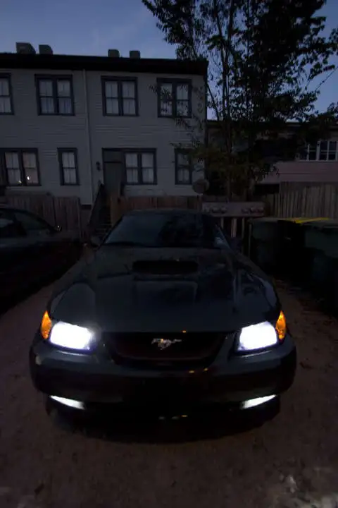

Here's mine with DDM 6000k in both the headlights and the fogs.

That's exactly the look I want for my 1999 GT show car, thanks for the picture stprorolla49.
