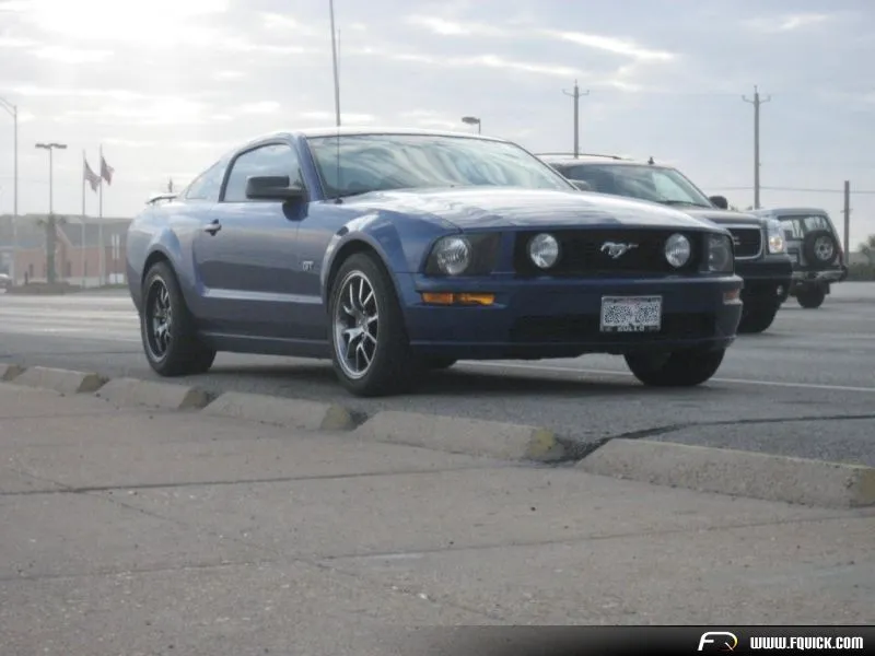

Does anyone have pics of there mustang with just the rear roush springs? I am thinking about doing this..... I would love to see how it sits. Thanks!:SNSign:
Here is one walter posted with just the Roush rears.
