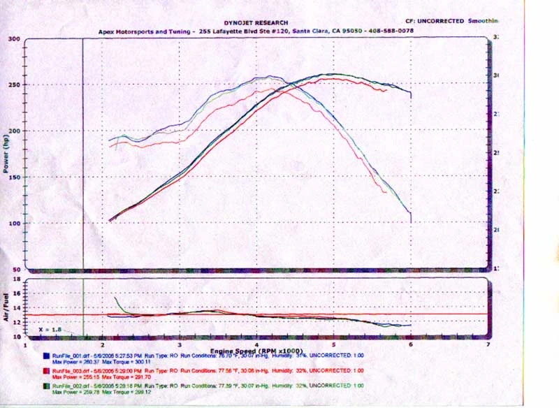

Just got back from Apex motorsports in Santa Clara. I did a baseline dyno before I slap on the FRPP blower this week. Here's what I pulled.
Run 1.
Max Power = 260.37 Max Torque = 300.11
Run Type: RO Run Conditions: 76.70 F, 30.07 inHg, Humidity: 31%, Uncorrected: 1.00
Run 2.
Max Power = 255.15 Max Torque = 291.70
Run Type: RO Run Conditions: 77.56 F, 30.06 inHg, Humidity: 32%, Uncorrected: 1.00
Run 3.
Max Power = 259.78 Max Torque = 299.12
Run Type: RO Run Conditions: 76.39 F, 30.07 inHg, Humidity: 32%, Uncorrected: 1.00
I'll post the scan when I get a chance later.
Do they seem correct for my mods? I was quite happy with the numbers.

do you by chance have the SAE corrected...the numbers you have seem to be STD
Here is a scan of the 3 pulls.
How do you get the SAE corrected numbers?
I also noticed that the A/F ratio is a little high around 3500 rpm, is it too high?
I guess it doesn't really matter since I will probably get an SCT tune once the blower is in.

nice, although it does highlight just how inaccurate rolling road dyno's are.
Between two runs you car made over 5rwhp loss, so when people add mods like exhaust or CAI and claim a 10-12rwhp gain, all or some of that gain maybe just an error in reading.
Hope it makes some decent numbers with the blower, but remeber the peak figures are not really important its the profile of the curves on the graph.
You could always create an average in the hope its more accurate, but what average would you use?
-mean
-medium
-mode

Yeah, also when I do the after blower install dyno, you have to take into consideration that the Plenum, pulleys and timing adjuster will be taken off so comparing the after dyno numbers to my current numbers won't really be too accurate.
As far as the diferences in the 3 runs, the tuner said that heat is the biggest factor. When I was there a supercharged 500 rwhp cobra had differences of 30 horsepower until they let it cool down.
